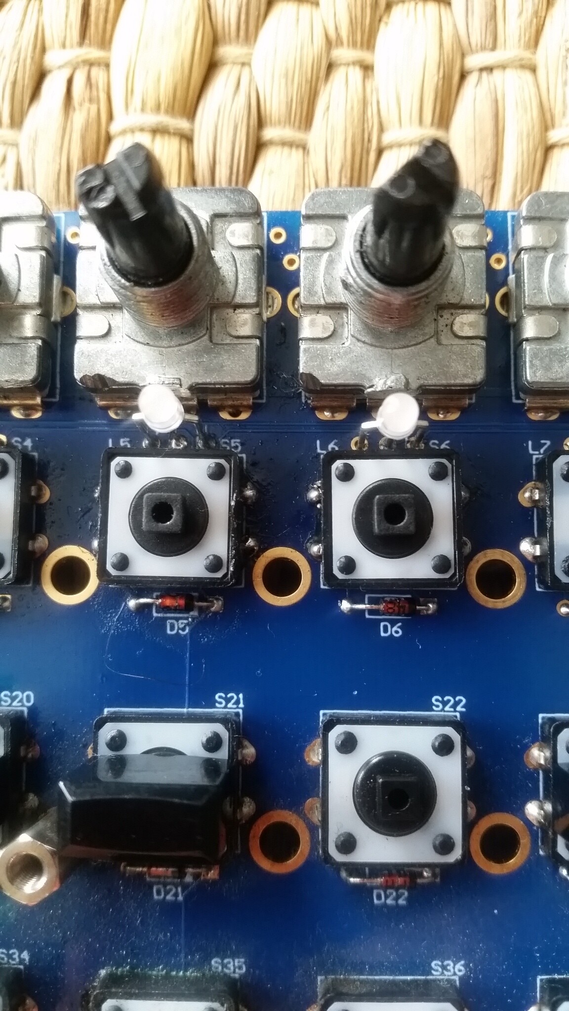

stepswitches 5 & 6 are not working (the guy who owns it tried to replace them…but he really did a grimm job soldering
i cant really see where the traces are going and to what ic these two switches connect (it can probably be fixed with a wire but i need to know to what ic and pin they are going)

ok traced them down to U2…and that side is okay…but still can not find the fault…are the switches connected to a groundplane or something ?
because he ripped off some solder pads

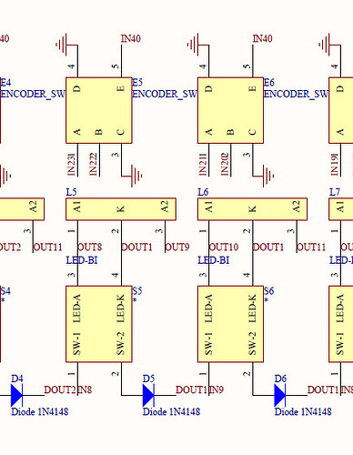

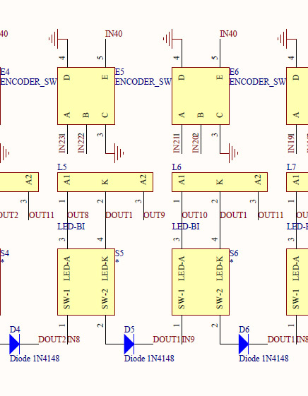

As you asked, the step switches are “in between” an input channel, the step LEDs, a diode, and an output channel creating the matrix, so no direct connection to ground - see attached schem region that shows the step switches 5&6 (center bottom).

Note that the Wilba board is wired in a way that the switch bodies carry some signals too. Think of the switch with two halves.
A A’
B B’
When the switch is not pressed, A still connects to A’ and B to B’. Think of it like a clipped resistor leg soldered between the two PCB pads. The idea/function is to act as a “bridge” to avoid lots of vias or a 4-layer board, as you can effectively jumper the signals over and under each other.
When you press the switch, then the switch acts as you think it should and connects parts A + B. Naturally all contacts are connected when the switch is depressed.
I would be tempted to load MB_NG and manually check the functions. E.g. you can read DIN events with set debug on (short the “cathode” part of the switch to 0V/ground) and simulate a matrix with set dout x y and try to gauge if the switch works that way.

ive been testing the switches…they give a beep if i put my meter on them  A-A gives a beep and B-B gives a beep
and A-B gives a beep when switch is pressed…
one other thing ive noticed…with my own seqv4 the step led lites up green when i turn the encoder…with this board the led does not light up when i turn the encoder
so that is weird
did some beeping again…as this guy…himself replaced the menu switch…he probably damaged a trace …
there was no connection between d21 and d35 …
so its all working now
