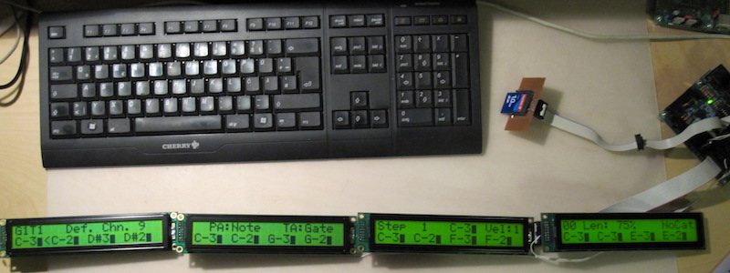

concerning the displays: I remember that I added an option for 4 LCDs to the firmware for somebody who had 2x20 LCD modules which were bigger than the common ones:
Picture was created 2010, not sure if such displays still exist
Best Regards, Thorsten.
