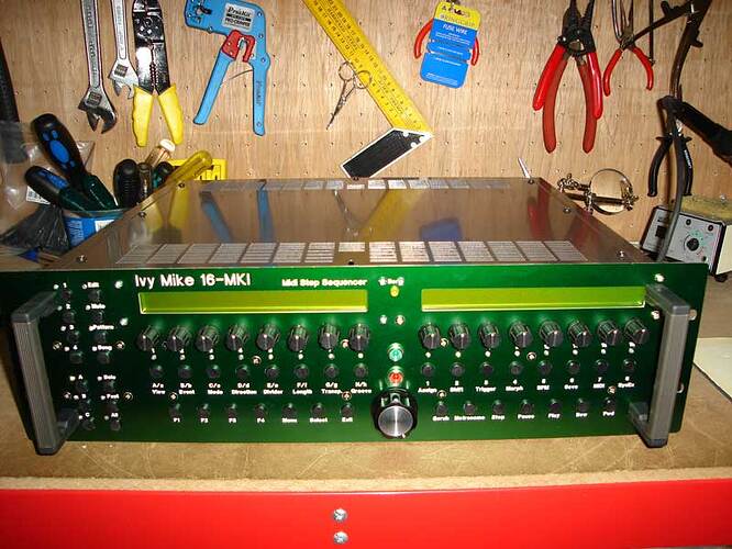

After nearly a year ive finally finished putting my midibox sequencer into its box and closed the lid {perhaps pre maturely!}. Everything is working great except for a few small bugs being:

Really great frontpanel work! :slight_smile:
Is this ready for the MIDIbox of the Week section? :slight_smile:

WOW great Work !  :o
Regards
MTE
thats frickin’ sweet :slight_smile:
Could you tell us about how the frontpanel was done? It sure is pretty :slight_smile:

Thanks for all your positive comments. I cant take credit for the front panel as it is TK’s design, I have just tweaked it a bit. The main differences between this design and the one you download from the midibox sequencer page for manufacture with front panel designer are:
1} I requested a green anodised metal from them
2} I added my artist name Ivy Mike etc to it for a personal touch {would have liked to have the midibox logo etched in too, but was too hard to get a front panel designer object of the logo, can someone make it for download??}
3} I added the LTC module and mounted the in/out lights for it on the front {the out light is not working, the LED is ok, the wires are ok, the LTC has been fine in other projects and shows in light but not out}
4} I used expensive ultra bright LED’s which I bought from aztronics here in Adelaide and chose some complimentary colours for the different modes
5} I pumped up the contrast on the LCD’s using the trim pots on the core
6} I chose some nice trimpot covers
Apart from those minor changes the panel is the same as TK’s. I will post a seperate topic with the making of this sequencer with detailed photos of every step of the constucution esp the panel so people can see the inside and copy it if they like. I had to try to figure out what to do with the panel as there were no clear photos showing the panel setup, and the panel itself did not fit my rack case, or any of the pots I ordered so maybe this could save people some time on theirs??
