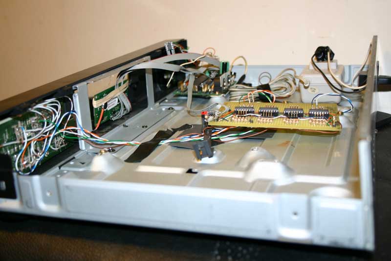

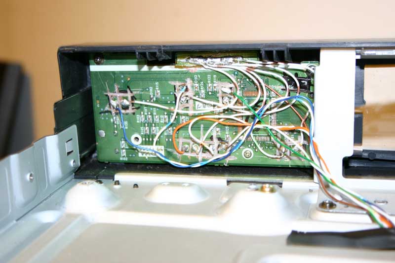

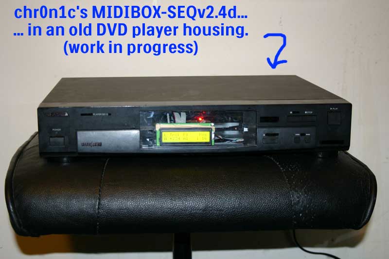

below is a few shots of the progress so far… one shot of the front, one shot of how i re-used the already in place front switches/buttons and one view of the inside as of a few days ago… it’s already in a much nicer state than the pictures show as i’ve done a bit of work on it since, so don’t laugh too much at it… (it’s a work in progress)
EDIT:  the PLAY and STOP buttons do what they are labled to do… the fast forward and rewind buttons move through the menus… pause is the menu button, open/close is the button to switch what i am editing in the menus.   i still need to mount the 16 GP buttons and the rest… (above and around the lcd maybe)
whoooaaaa!! thats what I call “Ghetto!”
It’s the sequencer Mad Max would have used…  :slight_smile:
Awesome!
i’m taking that as a compliment… ghetto and the madmax are both positive in my book!
