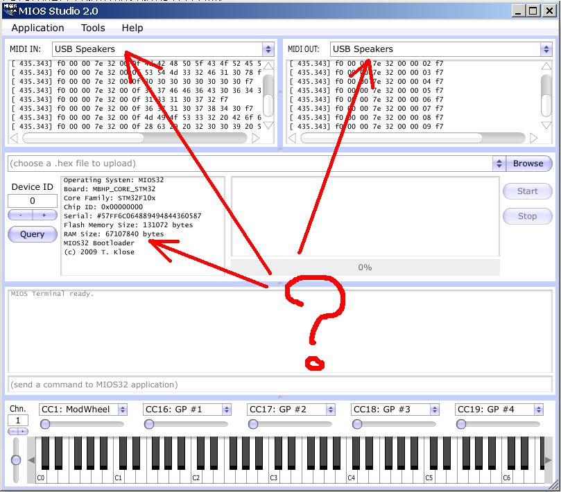

1° step : Upload MIOS32 bootloader with Flash Loader from STMicroelectronics , OK
2° step : Power cycle with boot jumper in NORMAL MODE no signs o flife , no led flashing, no USB recognition
3° step : Power cycle with boot jumper in HOLD MODE MIOS Studio 2 recognizes the core as “USB Speaker” ( Windows XP ? ),
reports correct operating system, board, etc. but a wrong ram size, over 60 MB !!
4° step : I try to load an application previously compiled successfully, no errors reports but nothing changes from previous step
When I compiled my test application with success (011_ain from programming tutorial) in the environment variables I specified the type of processor, it is sufficient?
The different processor “RB” instead of “RE” require other particular settings ?
If I fried the processor, this behavior is not strange?
Someone has an idea, suggestions ?

Hi,
the STM32F103RB is a very limited processor, it has only 128k flash and especially only 20kb RAM (instead of 64kb of the RE).
Therefore it normally doesn’t make much sense to save 1..2$ -> just use the RE and you are fully binary compatible.
I fear that most “real” applications won’t run on the RB, and as you already noticed, you will also find incompatibility issues and “random effects”
I guess that they are mostly related to RAM overruns if you are trying to run an application compiled for RE on a RB.
Due to historical reasons I’ve a special linker file under etc/ld/STM32F10x/STM32F103RB.ld which is suitable for the limited memory specs.
It will be automatically selected if MIOS32_PROCESSOR is set to STM32F103RB instead of STM32F103RE
After this change, type “make clean”, and thereafter “make” to recompile the complete application.
I don’t know if this change is sufficient, since I haven’t tried this since more than 2 years…
If the application is too big, the linker will fail.
Best Regards, Thorsten.
