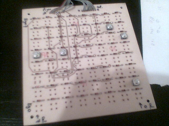

I have designed a board for the scan matrix created by bill and thorsten but for D9 (or KSA) buttons, not for the c64 keyboard. It is based on the schematic of TK (one diode for one button).
I have checked the lines, electrical circuits are goods, connections are right. Application in the PIC is scan matrix v1 or v2 (same behaviour) and mios 1.9e.
BUT if I let the frontpanel in the normal position (mean buttons looking the sky) and if I shake the board , it produces random note on and note off, event X on not always followed by the event X off.
If I return the board (mean button looking the ground) this erratic behaviour disappears, and the device works perfectly well.
So I have though to a mechanical problem the buttons are the classical D9 (or D6), maybe to poor quality for a so fast scanning (no real spring inside, but a shitty system using a coin an folded edges).

apparently, you have done a such panel. Did you use veroboard ?
Is there a possibility of using capacitors closed to the buttons ?
I repeat : the realy strange thing is that this panel works perfectly well if I return it , I mean if I use it with the buttons faced to the ground. That’s why I had though to a mechanical problem, especially that these buttons were in destock in a supply store.
I will check one more time the connection to DIN and DOUT tomorrow. But for me button quality is engaged …
Yeh I think it sounds like it has to be either: Your cabling between the PCB and core moving around and shorting/breaking when you flip it over …or… dead switches.
yes
this shouldn’t make a difference and is not required
Best Regards, Thorsten.

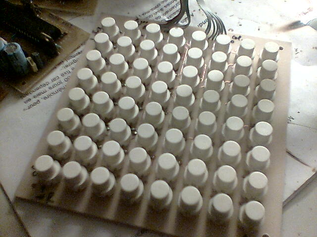

problem solved !
buttons weres defective. exchange with KSA works (but I had to fold them, cause hasn’t the same size than D9), pin compatible.
soon : the PCB, but I have to add info like col/row number for buttons and C0-R0 for connecting, and front/back side.
