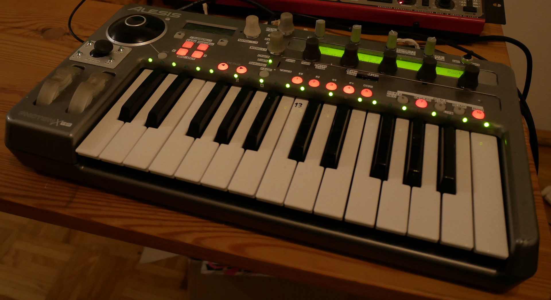

scale explorer - konga trigger - sequencer
a lot of pictures of the build, some explaination:
http://wiki.midibox.org/doku.php?id=scale-explorer#teaser
some coding and real world jamsession has to be done the next months, so i dont uploadet a code yet…
What it does shortly:
Indicate via LEDs over the Keys, what Notes fit to the actual set Scale.
I preprogrammed 240 scales, when i change the root note (on the fly) this are 2400 or more scales…
programming scales, and songs is easy - just play a melody! or connect your sequencer in feed Scale-Explorer with your song! (root +2 +2 + 3+ 3+ is a scale for example… but it dont matter in which order you press it, my code detect its order)
so you can indicate what scales, or notes you use in your song, or indicate what your Jaming Partner is playing on is Gitarsynth or Keyboard or Sequencer (in the case you dont hear notes as “notes” like me!)
the songmode, is a “always recording” one, that means, you hit record after you played what you wanted to record… its more easy to not “try and try and try to make a perfect record” just jam, and when you think - whoo hoo that was awsome! press Record, set the loop points (which in length are always multiples of the set tact 4/4 leading into 4 8 16 32… 3/4 to 3 6 12 24…) and maybe press “purge” to clean not used notes and to shift it to Step 1…
8 Songs per scale are possible
128 scales are saved on one preset which can be loadet from sd-card, each scale can hold 8 songs/song parts, which is saved as 1 song on the SD-Card, that song is automaticly loaded by changing a scale…
So the SD-Card is pretty full with songfiles…
There is a Trigger Amplifier and Schmitt trigger built in (Konga Trigger), which retrigger the pressed Keys, or Trigger Songsteps and go to the next song step while you can hold a step with Footswitch or Reset the Song to Jump to Step 1…
Last Jamsession, i was sitting on this Wood-SnareDrum Instrument, clamped the trigger mic on the bassreflex opening, recordet a short snipped of the keyboard a other person played, and began to play the base, snare and “Wood” part of this 8 man Jamsession, in short time i was leading the thing, because Snare Wood Bass and its melody was fitting in this environment… i loved it! i am not a good drummer, or keyboard, but this for me was the holy grail, Electronic Music with real Humans instead of clock driven sequencers…
i hope i can get you a video next month!
