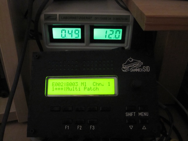

are 500mA really sufficient for 2 SIDs + the big variety of LCDs which are used for this project? (some backlights draw only 100 mA, some others 300 mA and more)
The result could be, that the input voltage drops below 10.5V, so that the 7809 won’t output 9V anymore -> the filter won’t work correctly, or there won’t be any sound output at all.
Another possible effect: the PSU gets hot because it isn’t dimensioned for permanently high power consumption.
Low-quality PSUs will be damaged over time (1..2 years) if they are used out-of-spec - I had this issue several times in the past.
I recommend to all builders to keep the backlight pot set to half-way or less… the pot is 50K, changed from official Core spec of 10K, so there is some real current limiting… also there is a header/shunt for powering “high-power” LCD backlights from input power. So in my experience, a 12V AC 500mA power supply is OK, and if you turn the brightness up too much, the current draw will cause voltage to sag and the PIC will reboot (or not boot).
When the PSU is regulated, you can choose a higher current rating without any concern, but for unregulated PSUs, going higher than 500mA causes more problems, input voltage will be much higher, thus the voltage regulators will need to dissipate more heat (and powering the backlight from input power becomes more fault-prone).
