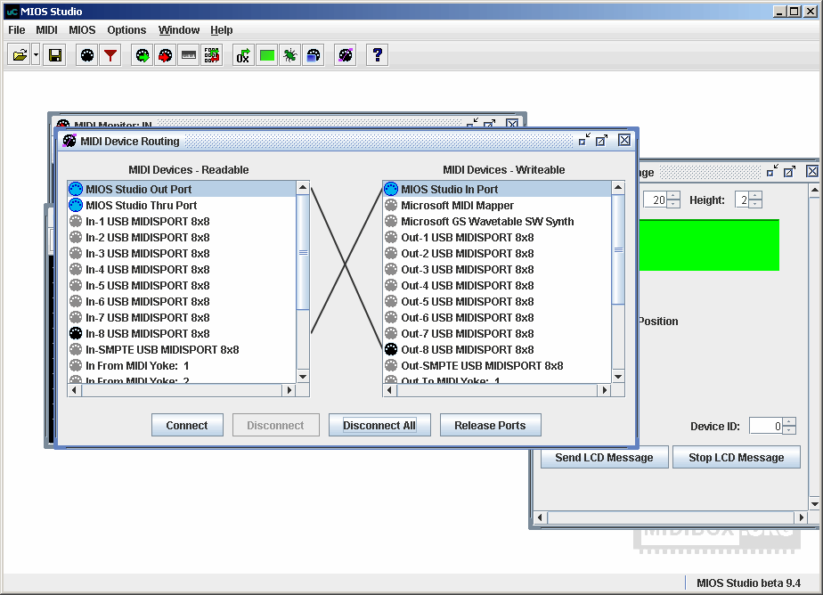

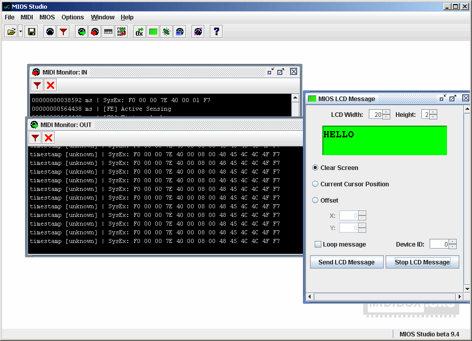

Then I tried to send a new LCD message to the unit to no avail. The following is a Print-Screen of MIOS Studio’s output.
My MIDI setup is below:
My JMI jumper is set correctly and I’m 200% sure my solder points are as awesome as cats-in-a-bag.

EDIT: I’m a moron and forgot to install the 6N138. Sorry.
