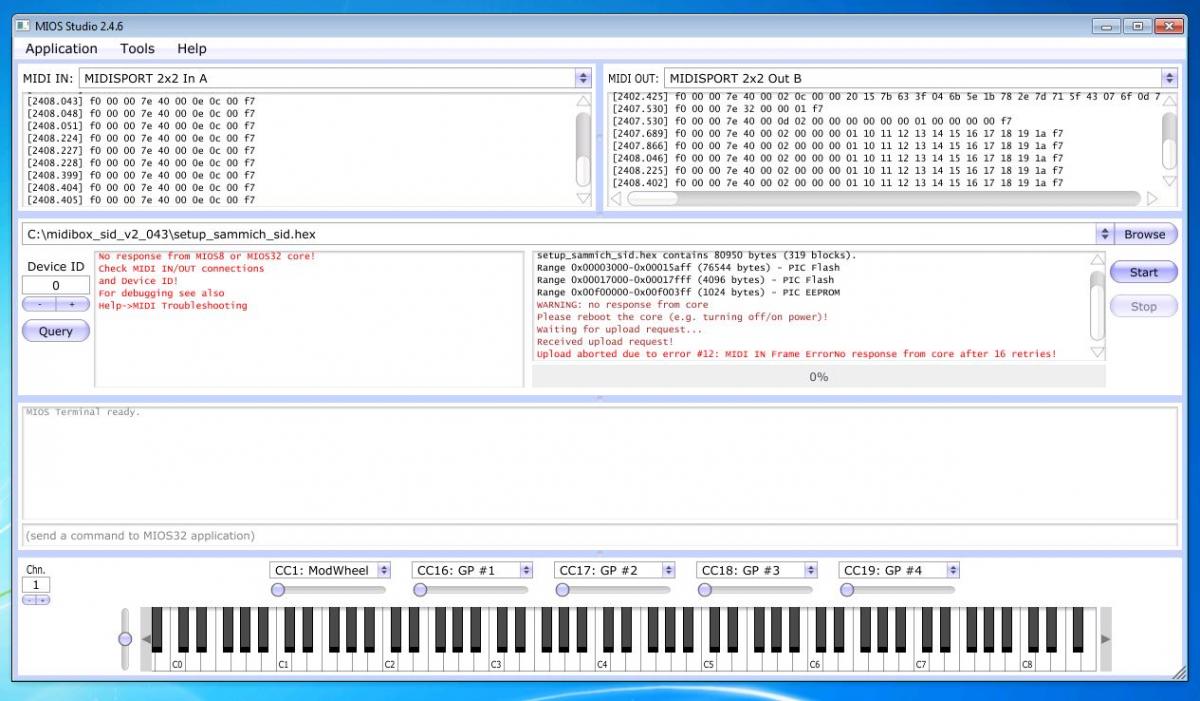

My problem is that no matter what i do, it doesn’t seem to want to let me upload the hex file to the PIC/Sammich.
when I first power on the sammich, if i press query in the mios studio immediately, i get the screen telling me its connected to the core and ready, and then i browse for the setup_sammich_sid.hex and hit start, and then it tells me it can’t contact the core and to reboot the sammich, which i do, it tries to do it then it says it can’t it and gives me an error saying:
Upload aborted due to error #12: MIDI IN Frame ErrorNo response from core after 16 retries!
It only ever seems to give me the connected to core message immediately after I power it on, and press query, and then only very briefly, from what i understand, it is supposed to keep polling every few seconds for an upload if it doesn’t have mios/hex burnt in.

I will post some screenshots incase anyone else can help by looking at them, any help is greatly appreciated.

When I query the Core with MIOS studio I am getting the following response
f0 00 00 7e 40 00 0e 0c 00 f7
What does this sysex string indicate?

    0x0c | MIDI IN Frame Error (Bad signal/Optocoupler)
You got 0xc -> bad signal or optocoupler.
If the resistor values are ok now, try another 6N138
