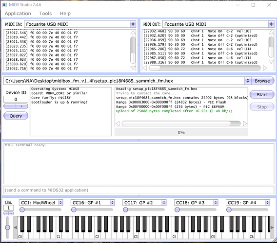

After installing MIOS Studio 2.4.6 and setting MIDI in and out the upload requests keep ticking-in all the time that the sammichFM is connected. After pressing “Query” I do get the correct message that the unit is up & running. I upload the midibox_fm_v1_4i, which seems to be working;
upload of 25088 bytes completed after 16.55s (1.48 kb/s)
But the unit isn’t rebooting after that as its supposed to. The screen is on but still just showing the row of rectangles. And the LEDs are all off. If I press “query” I get the message that “Bootloader is up & running!”. The requests “f0 00 00 7e 40 00 01 f7” keep ticking-in in the top left window. If I connect audio out its giving of some low random static noise.

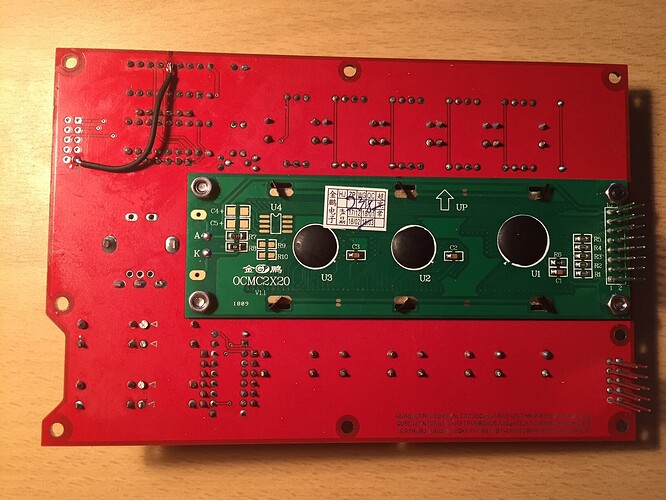

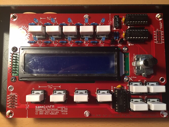

Here are some pictures. This is my first synth-build so I’m sure there is a lot to be said about soldering quality. :wink:
Generally quite good soldering but look for example at the resistor joints below the sandwich icon (fourth picture). Some could be cold, i.e. the fillet does not bond to the PTH properly.
If the voltages check out, I’d also suggest to install the bankstick ICs and load the default presets. I don’t know how the storage works without, plus there may be some inputs left floating.
