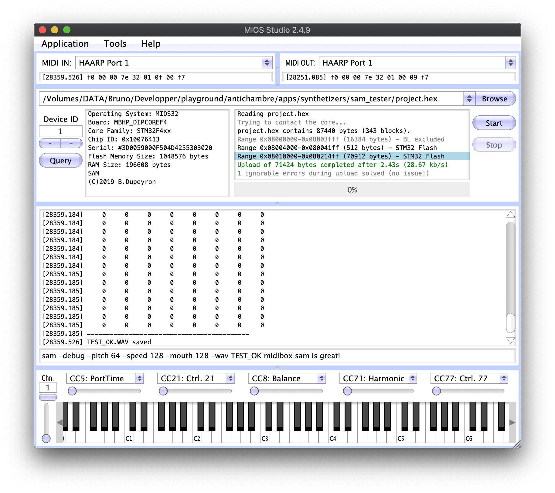

For us it must be realtime process… But as a start: For input the easiest first way is to use MIOS-Studio Terminal for SAM commands, and output wave file to the SD card. It’s not real-time but just an example.
Something like that:
[28337.121] SD Card status 1
[28339.122] SD Card status 3
[28339.122] SD Card CONNECTED
[28342.433] help
[28342.435] Welcome to the HAARP Terminal!
[28342.435] Following commands are available:
[28342.435] sam_usage: SAM Usage
[28342.435] sam: SAM
[28342.435] reset: resets the MIDIbox (!)
[28342.435] help: this page
[28345.225] sam_usage

[28359.145] sam -debug -pitch 64 -speed 128 -mouth 128 -wav TEST_OK midibox sam is great!
[28359.147] text input: MIDIBOX SAM IS GREAT!

[28359.159] ===========================================
[28359.159] Final data for speech output:
[28359.159] flags ampl1 freq1 ampl2 freq2 ampl3 freq3 pitch
[28359.159] ------------------------------------------------
[28359.159] 0 9 6 2 46 0 81 61

[28359.185] ===========================================
[28359.526] TEST_OK.WAV saved
Thank you!
Open a new thread in user’s project please, named MIDIbox SAM, a MIDI speeching box… something like that.
I will share what I did in it…
< base_url >/topic/21970-midibox-sam/?do=embed&comment=188759&embedComment=188759&embedDo=findComment
Done!
