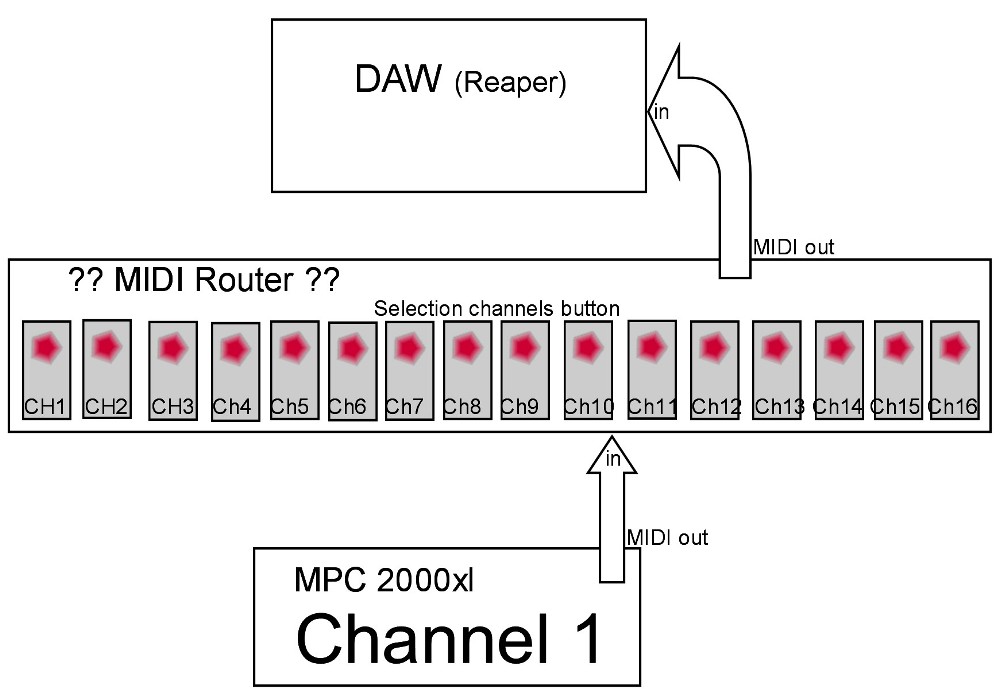

I have a MPC2000 and I would like to make a router for Channels MIDI.
I would want one button by channel.
Thus 16 buttons of selection (with a led temoin why not).
Do you think that it is possible?

Hi,
yes it is possible. You will need to make a customised version of the Midi Router.
Look here.
Regards
Tim.
