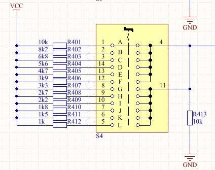

hi matcom3,
i believe ilmenators solution would work, but as you want to use rotary switches, encoders are not the proper solution for you.
had the same problem before and have attached a part of the diagram from my project. you can find further infos, including pictures of my pcbs, using rotary switches, here:
http://www.chipkit.net/forum/viewtopic.php?f=15&t=2561
i made this before i came across midibox, but it will still work with that. the idea is to use the rotary switch as part of a voltage divider. the output of the switch has to be connected to an analog input. because the switch-output is pulled down to GND as well, you wouldnt have the problem with “open” analog-inputs. you need to modify your program to read out the switch, so it doesnt accept 0v between 2 switch-positions. worked fine for me…:slight_smile:

hi matcom3,

sounds like a waste of inputs to me. cant see where the problem with my solution is either. the rotary switch is connected just like a poti. to be fair it is rather annoying to solder 12 different resistors for one switch, but it works a treat!

i agree, that in theory there will be differences between the resistors. the resistors will have tolerances as well. the ones ive used are 5%, but ive choosen the 12 resistor-values for a good reason. if you start with the first switch-position, the next position will give you a value, that is much greater then the one before. the absolute value of the switch-position doesnt really matter as long as your program can determine one of the 12 switch-postions! from that you can calculate your desired cc-value…:wink:

Your schematic diagram shown will work if each of the switch units have separate resistors (13 ea) for each switch.  Thats 104 resistors.  What I would do is take 13 - 470 ohm resistors and put them all in series and connect one side to VCC and the opposite side to ground.  This gives you a reference voltage for each of the switch positions.  Connect each resistor node to your switches.  Now the wiper side of each switch can connect to separate analog inputs of your core processor.

I just noticed that the schematic I was referencing in my last post was from “mono” and not you “matcom3”.   There was talk about analog inputs not being terminated when switching values.  I was wonding if the capacitance of the inputs might be enough to hold the value for the time that it takes to go from 1 position to the next.

I just noticed that the schematic I was referencing in my last post was from “mono” and not you “matcom3”.   There was talk about analog inputs not being terminated when switching values.  I was wonding if the capacitance of the inputs might be enough to hold the value for the time that it takes to go from 1 position to the next.   Pete

You are right about the volttage values will change depending on the load of the analog input impedence but this would be very small.  The resistors were just to know which position the switches were in, not to give an exact voltage as to the CC value.  Software in the core would need to be changed to look for a range of the input voltage for each switch position and output a specific value to the synth from a table lookup or hard coded in the software.
@all: i was talking about a practical circuit to give an easy solution for the problem. it was not meant to be a start for a scientific / philosophical discussion about voltage dividers and stuff.
@kpete: thanks for that! this is exactly what i meant in my first posting. the resistor values are e12s. the difference between each step is big enough for the software to determine, which one out of 12 steps is selected. the absolute value doesnt matter at all and it has nothing to do with the cc-value, that you want to send either.
also i cant understand, why theres a capacitance on the analog-input / switch-output. in my diagram you can clearly see the 10k resistor pulled down (!) to GND. this ensures that, if the switch is between 2 contacts, the voltage on the analog input is pulled down (!) to GND. no open inputs, no capacitance, just GND. obviously the software needs to detect this and shouldnt send anything in that case.
i know, that it sounds a lot to use 13 resistors for one switch, but the benefit is, that only 1 analog input is needed per switch. in my case ive even connected these switches to analog multiplexers, that is 8 rotary-switches per analog-input. so theres plenty of rotary-switches you could connect to one mcu or in other words loads of money to spend on these switches.
@matcom3: in a practical use, i would go for smd-resistors anyway. for the smt-machine its quite easy to place 13 0805-resistors per switch “somewhere” near the switch, so i didnt worry too much on that. have built a prototype with 16 rotary-switches. it took me a while to solder more than 200 through-hole-resistors only for the rotary-switches, but im very pleased with the result. it works just fine and you get a very neat “vintage” feel with them. apart from that 12 switch-positions are exactly the amount of keys per octave and you cant beat that feeling with any rotary-encoder..:smiley:
mOnO
