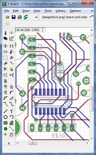

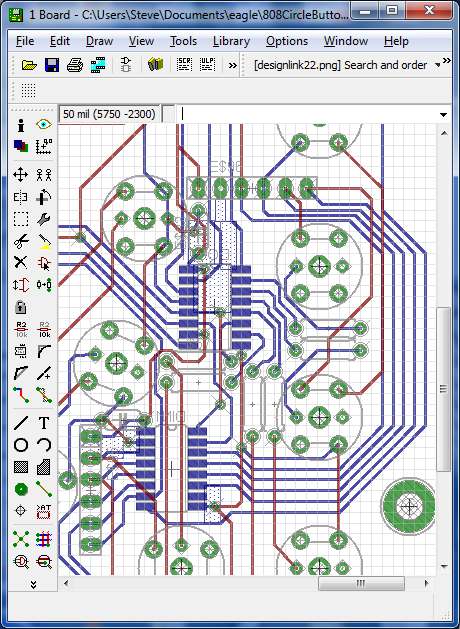

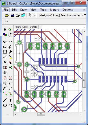

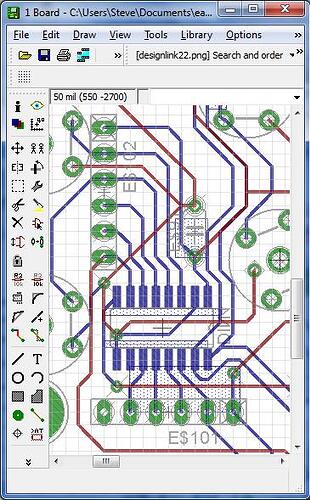

I don’t know if it’s any help or not, but I’m attaching a couple of pics that sort of illustrate how I did it… at the very least it may give you some ideas. I think you can click the thumbnails to make bigger images
The first pic shows a basic DIN SR with pull-ups right by the IC.
The second shows a DIN SR where I didn’t have room for the pull-ups. This was the last DIN in my chain, so not all pins are used.
The third shows a DIN SR where there were other components and traces in my way, so I had to move the resistor network to another part of the world.

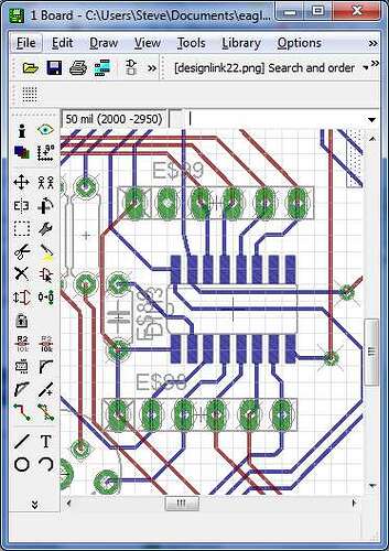

Thanks for all the help (both Nebula and nILS). Wish they had SMD resistor networks like the through hole ones you provided as an example. The only ones I found were basically individual resistors in a single package, which actually made it more difficult to route things to my buttons.
Thought about using the through-holes as you have. Still debating on that actually. So far, the individual SMD resistors don’t seem to be causing any issues, but I’m not done routing everything yet. This board has 3 595’s and 5 165’s (it’s for the OSC and ENV sections of my control surface).
Tried using through hole resnets and actually they helped far more than I thought they did. I have them more or less next to the SMD chip and it’s nice because I can still run traces through the gaps between the holes and can use any layer to connect to the buttons without having to make a bunch of vias on my own. Good suggestion! I’m going to try it on my other boards as well as I am using individual resistors on them and like to keep the parts more or less the same across them.
