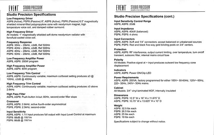

In enclosed manual, 200VA stated to be normal (attached below).
manual available onlinesays even 100VA being satisfying power requirements.

Currently I have 750VA (!) stepdown transformer, 220-to-110, single unit for both monitors (pictured).
My question: is this one is ok for my application and which working temperature of this transformer is considered to be normal, for that matter.
Plugged to 220V, after about a hour it already gets VERY hot - that much so you’re not able to hold it in your hands. And this without being plugged to anything else.
Is this normal? … This is my second supply of these types; first was replaced due to low VA (200).
Every advice regarding the issue, such as spitting some ice on top,  :stuck_out_tongue: or placing it in a lead ‘shielding’ enclosure/getting another type (lower noise?) transformer and alike is more than welcome.
