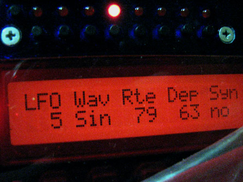

I tried to hack LCD for red light but I failed.. First I tried do make new background LED illuminated diffusor which didnt difuse well, and second try is just adding 3mm thick transparent red acrylic sheet on top of LCD. Result actually looks nice but dimmed. On picture looks better than in real because of higher ISO setting of my camera. At night its OK, but  not by day - waaay too dimmed. I also tried transparent PVC sheets but les than 3 layers look more dark yellow than red and 3 sheets of PVC takes all the sharpness of characters… I gave up… ::)
Judging from the picture you did a pretty good job at the hacking :wink: But I can imagine that 3mm of acryllic dims the light lot.
Those yellow-green backlight displays usually have a green-ish background… i.e. it’s green even when the backlight is off. That probably won’t help reflect red light. If you’re hacking :wink: the black-on-grey edge-lit LCDs might be your best solution, but they’re probably just as hard to find in 2x20 as black-on-red, and you’re still stuck for getting good contrast. I think a green PLED would compliment your red LEDs very well, even though it’s not red, you’ll probably enjoy the much better contrast ratio and view angle.
