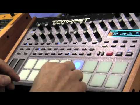

Btw. woah, the OLED on the new Dave Smith & Roger Linn Tempest looks mighty fine :slight_smile:

By the way, the Tempest looks pretty damn cool! Been looking at the Maschine as well recently (friend of mine and fellow MidiBoxer let me play with his last week). Have to wait on either of those as there is much MidiBoxing left to do (60% done with my sammichFM and still need to finish my CS board designs for my MB-SID) but man there sure it plenty to droll over these days!
