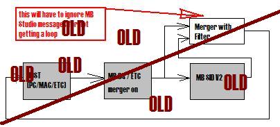

EDIT: I’ve added a small sketch. outdated
Problem: When the recorded events are played from the Host they get through the merger again, what means that sended events are received again by the host (=> loop possibility)
EDIT2: I’ve added another sketch
Due to the above written problems I searched for a new solution. As this seemly doesnt need any modification on the firmware this could be the last post on this prob in this topic.
The yellow rectangles are showing 2 areas where we need to merge 2 signals into 1. The MidiMerger of the SID is turned off in this case. So there’s my probably last question … is it possible to add a 2nd MidiIN to the SID with an IIC module or do I need to build a seperate Core with the merger software?
EDIT3: Perhaps it’s the easiest way to integrate a MBrouter with 2 iic’s into the case.
