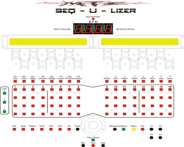

I was thinking it could be worthwhile to consider a new CS layout with the new version, but aside from the addition of a few buttons, it seems like the v2 UI is just fine…
What do you think TK? Is it worth creating a new kind of layout for those who are building a new v3, not upgrading an existing v2?

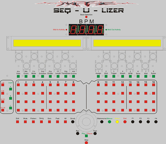

Hi :slight_smile:
Yoh look thats my idea about the new Seq V3 layout (->attachment)
the quadratic Duo-LEDs works as buttons…also there are 4x 7-segment-digits for BPM-Display, cause i readed in another post TK will implement them…I hope it will work for 4 pieces for " 120 ,x" BPM :wink:
Enjoy
MTE
A thought…where a button can be held in place to act like a ā€˜shift’ button, you want all those buttons together, on one side of the CS, so that you can use one hand to hold it in, and the other hand to hit the other button :slight_smile:
You should also add four dedicated buttons/leds for choosing between track groups:
  1. Tracks 1-4
  2. Tracks 5-8
  3. Tracks 9-12
  4. Tracks 13-16

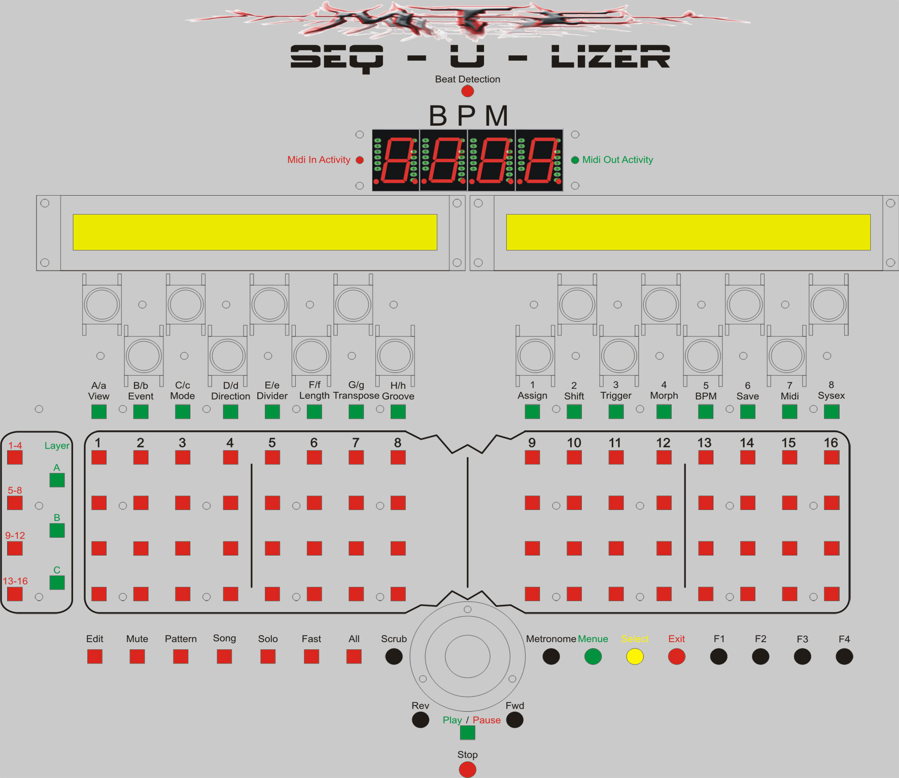

Updated :wink:
the other hand is mostly busy with tweaking the rotary encoders… :wink:
Shift buttons are a nice possibility to save money, but they mostly lead to compromisses
Best Regards, Thorsten.
