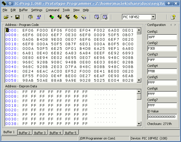

I checked the .hex file my friend and I were burning on PIC, but it seems that the ID is exctly what I want - 0000000000000000 (screenshot attached). Also in source code of bootloader all options are set to 0 I loaded the bootloader_v1_2b_pic18f4620.hex file into IC-Prog and selected few pic18s - because there were no pic18f4620, I tried a few others - everywhere ID was 0. And from what I found out, this is correct - I use standard MIDI, 2x40 character lcds and I don’t want to chain multiple midiboxes. So it seems that it’s not the matter of ID.
