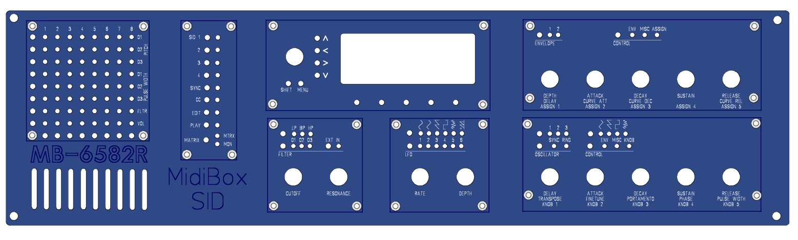

testI don’t have the measurements yet for the 3U panel (I think I’ll just have to buy it and measure I think) but I think I can eyeball it enough to keep working on the panel. I switching things around to looking more like the original C64 interface, albeit with a different arrangement.
I have added a few front vents too - I liked the idea of pulling air from the front instead of the sides so I can make sure air will go over more of the heatsinks on the SIDs (I’m planning on using a fan out the back on the same side so airflow should be largely straight through).
http://discourse.midibox.org/t/topic/14927
I am also thinking about using illuminated buttons for some of the single button/led items (such as the SID selection). Since I am using the same LED wiring as the MB-6582, I am a bit worried about how noticeable the different outputs of the LEDs might be though. I noticed that e-switch has quite a few options and EAGLE already has the templates for quite a few of them (that’s how I found them :P).
I will likely remove the line-art too from the sections (such as LFO). I might, instead, put them in larger print on the sides since I have room for it, but I dunno.
Still a work in progress but I was excited and wanted to share :slight_smile:

you can use spacers with jb-weld like wilba used with the mb6582 , and don’t forget to use the 2.54 grid .
Yeah I have been going back and forth about JB-Weld. I had to re-weld a few spacers on my MB-6582 and one of my corner screws popped off while I was experimenting around with right-angled SILs. That said, I can’t easily make a single-board solution so I was going to have smaller (thus lighter) boards such that JB-Weld might not be so bad. I do worry a bit about boards falling off and causing shorts and things. If I can find flat-topped screwed such that they are flush to the panel (or close anyway) I don’t think I would really be bothered by them. In fact, they might go good with the blue color of the panel. As you can see I haven’t made up my mind yet :slight_smile:
You might have busted me on the 2.54 grid though. Are you talking about for FPE, Eagle, or both? I assume 2.54mm?
Most component grids are 2.54mm, so both board and frontpanel grid should follow that convention.
Ah .1 inch. Got it :slight_smile: There are places where I was using a .25in grid so I’ll have to change that. Generally the panel needs some cleanup but I need to start making prototype control surface boards before I can really hone that in I think.
As an aside, I find it weird metric is not used more in board design. This whole idea of MIL seems silly when metric would have worked a lot better (IMO - and that’s coming from an American that believes the USA should switch over to a sensible measurement system :slight_smile: )

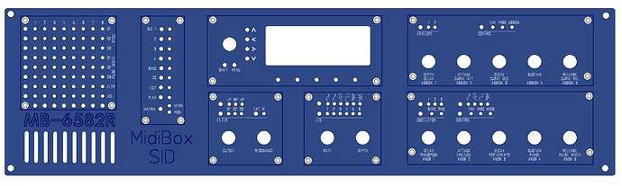

Rackmount chassis arrived from Jameco today so I updated the panel with the screw holes. I don’t have one of those fancy digital spanner things yet but eyeballing it I was able to get things pretty close. Likely close enough for things to work but I will have to remeasure it before dropping $200 on a panel :slight_smile:
Anyways I made a buncha changes so thought I’d share.

Being a big fan of symmetry it seems kinda odd to me that the OSC and CONTROL sections do not align with the FILTER and LFO sections. Also, the engraving seems horribly close to the LEDs on OSC and CONTROL. That seems to mostly be the case because of the logo, which also leads to the screws being all over the place. Not even the knobs are aligned vertically…
Are you a southpaw?
I would also consider switching the fan thingie and the phones jacks. Everything that has cables coming out of it should be as far away from anything else as possible imo.
The way you have laid out the two rows of buttons per section seems kind odd as well… For the LFO section, the LFO selection is the 2nd row, while on the OSC section, the OSC selection is the 1st row.
Ah you busted me on not fixing some of the text objects. I am using a .100" grid most of the time but need a .05" to fix the text and I just forgot to do that after moving stuff around.
I actually thought the filter/lfo location looked kinda cool myself :slight_smile: I intentionally moved the screw-holes down for the logo actually. In terms of symmetry, at least when looking at that section (the middle section with the LCD), I thought it looked pretty neat. The section I don’t like is the matrix / SID selection sections. It’s been when I moved the screws further apart on the matrix to match stuff but they look a bit weird if you look at the top screw-holes over the bottom.
Good idea on the phones thing, though may have to play around with that anyway. I sit on the right of the synths so I would want the headphone jack to be on the right. Previous attempts and switching the matrix and osc/env sections did not go so well but I think I have the basic layout of the sections done such that it may not be as much of an issue.
Yes, depending on how you look at it, the OSC selection is flipped. Originally, I tried to make the most important thing on the top row. So in this case, for me, sync/ring is not as important as the OSC numbers. For the LFO, the type is more important than the number - same for the filter. I sort of see what you mean now when looking at all the sections. I dunno if that would bother me directly but yeah will probably look a bit strange. I tried using single rows of buttons but I started running low on space without things getting really cramped - I can’t make the matrix/selector sections much more narrow - not enough to likely fit the additional space the LFO/Filter’s needed without really breaking symmetry. I tried various ways to do that but didn’t come up with anything better than using two rows - though I’m certainly open to suggestion there.
Yes I’m a soutpaw :slight_smile:

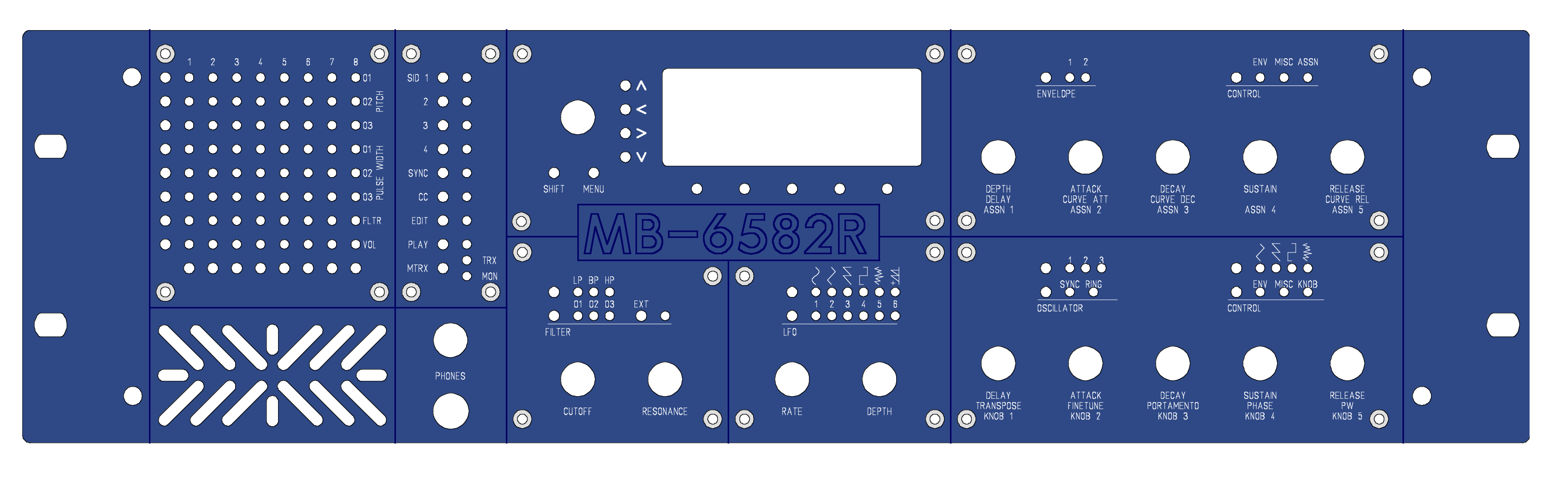

Sounds good. I’m going the modular route to save on cost so I can 1) troubleshoot each area 2) remove a module if needed) 3) add more modules if need be 4) finance to save on costs. I’m going to do a bit to the front panel to clean it up but all in all it looks excellent. I’m going to use that 3U rack from Jameco as well. I would not be hard to fabricate a front panel board for this project though I too do not have the software and time to do so. This seems a great solution if someone wants to add to their pre-existing rack. As far as the heat flow, you could have a fan intake in the front with a fan blowing out the rear for a push pull configuration. I was thinking that the SID won’t draw that much heat if a proper PSU is used and since you opted for the 12v design. As far as the voltage regulators, having a heat sink protrude out the back side of the case isn’t out of the question either and have them mounted with thermal compound. I’ll try to work on the design tonight but exams are this week so I don’t know how much will get done.
Just did some general adjustments with symmetry and tweaked to taste.
[mb6582-R.fpd](< base_url >/applications/core/interface/file/attachment.php?id=8423)
Ah I see you went with black. Not a bad combo. Only minor issue I see is that the buttons on the OSC are wider apart than the filter/LFO.

Ok, fixed the panel, now it is symmetric.
