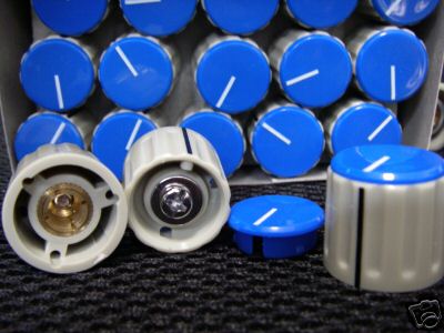

I have narrowed down my choice of knobs to 2 different kinds. The faceplate is going to be made from red Texalum/carbon fibre (basically carbon fibre but all red). The 2 different kind of knobs im choosing from are:
or
I think i prefer the blue ones more slightly… although the black ones (which are aluminium on the outside) are considerably cheaper.
They thing that makes me wonder is the blue ones are a brass insert. Would I be better off spending slightly more cash and going with them? Id imagine if you take the caps off and on a few times the little lugs inside the plastic ones would wear down quite quickly?

mainly because this is my first project of this scope and I figured there is a good chance I will have to pull it apart and put it together a fair few times :slight_smile: not to mention when its finished it will be used for actual gigging where it will take a few bumps im sure. And the OTHER problem is..i like both of them! hehe…although Im starting to lean more towards the blue ones (with a blue LCD perhaps? would match my midi keyboard with blue LCD (M-Audio Axiom))
… the blue ones (with the brass clamps) are collet knobs, which are not made for burled shafts but for plain round shafts.
Greets, Roger
really? the advertisement says they are for split shaft pots? i assumed that was the futurlec pots were?
The futurlec pots have a split and might work with a collet, but that’s not really the idea. That split is just to keep pressure on the slip-on knobs, so they’re nice and tight. Also helps with 6mm vs 1/4inch sizing.
