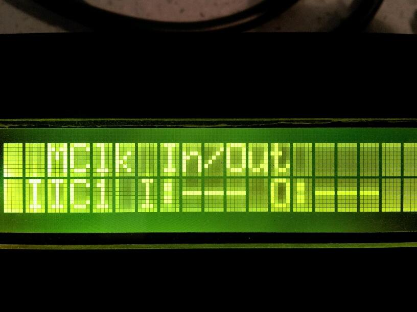

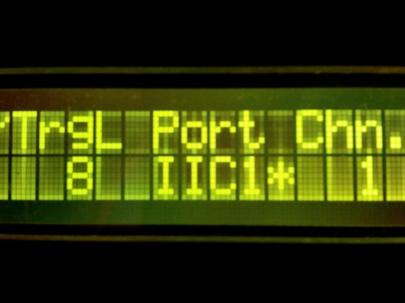

When I boot up the SEQV4 and hit play all the led’s on the QUAD II will blip on but when I stop the sequencer and restart it the led’s will not light… Also noticed when I want to set midi clock for the ports on the QUAD IIc the In /Out option does not work… If I select Menu / Event / Port and select QUAD IIc I get the following … IIC1* IIC2* IIC3* IIC4*…

IIC1*…IIC4* (the Asterisk) indicates, that the communication with the appr. IIC MIDI chips was failing.

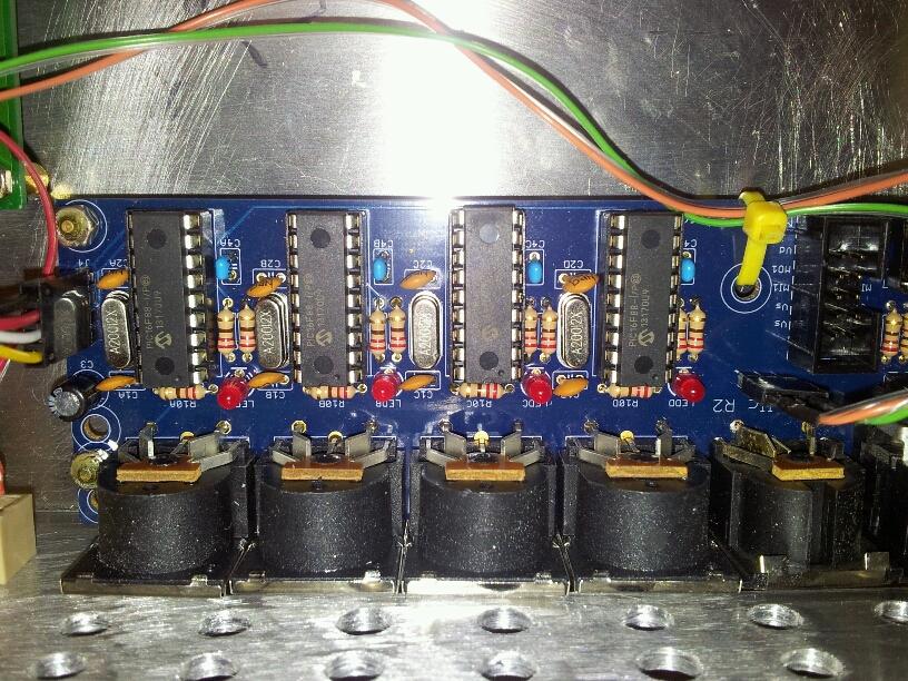

Not much happened running MIOS… Pulled the QUAD IIc out and will go over the solder connections… Just want to verify is there only one connection to the QUAD IIc via J4a (LPC) to J4 (QUAD IIc)? The 2x5 box header I assume is to connect other QUAD IIc modules as that is connected to nothing…
Still not working after the following…
Rechecked component placement and orientation…
Pulled chips and reseated
Reheated all solder connections…
Try’d MIOS troubleshooting but not getting far with it…
It seems the QUAD IIC works kind of… When I power on the the sequencer and then hit play all 4 led’s on the QUAD IIc flash once then go out… When I stop the sequencer and hit play the led’s will not flash they only flash after the sequencer has been rebooted… Is there code on the 4 pics that could be corrupted causing this? i am not getting far with this so I may just have to buy another QUAD II c module…
Okay I think I may be onto something here as I have the QUAD IIc connected to J4b and not J4a and that my be causing my issues … See below… Will switch to J4a tonight and hope it works…

Awesome!!! Changing to J4a fixed it QUAD IIc is working no more “*” when I choose the port… Now I can wire up my rig…
