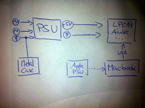

Ok, here is the setting:

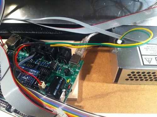

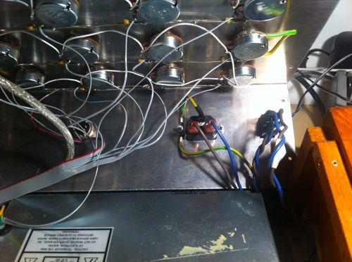

  • I have a keyboard controller case with a metal top. It is powered by an internal PSU which gives me a clean +5V for the LPC17. On the mains connector the two AC lines and the GND are connnected to the PSU, and the GND is also connected to the metal case.
-  the PSU output is GND and +5V and is connected to J2 of the LPC17. The USB power option jumper and J1 are not even stuffed on the board. As mentioned on ucapps I made a bridge between the outer pins of the missing 7805. The LPC17 and all connected boards, pots, displays etc. run just fine.
  • When I connect the LPC17 to a (battery powered) macbook via USB everything is still running fine.
  • But as soon as I connect my apple power supply to my macbook, I measure +28V between GND on the LPC17 (or Ainser64) and the metal keyboard case. I just realized that because a GND wire coming from the AinSer64 was touching the case and destroyed the MCP3208 on the AinSer board, two times …
When I deconnect the macbook’s PSU the voltage is gone.
-> Where is my error? Has anyone an explanation for this? Is the keyboard PSU faulty, or the apple PSU, or my macbook?

Is your Schematic correct? I see the same symbol after the PSU as before.
To Test you can measure GND (after PSU) to Earth. How much Ohms do you measure between those 2 Pins?
Thank you guys,
novski, there is no connection between these two points, they are isolated.

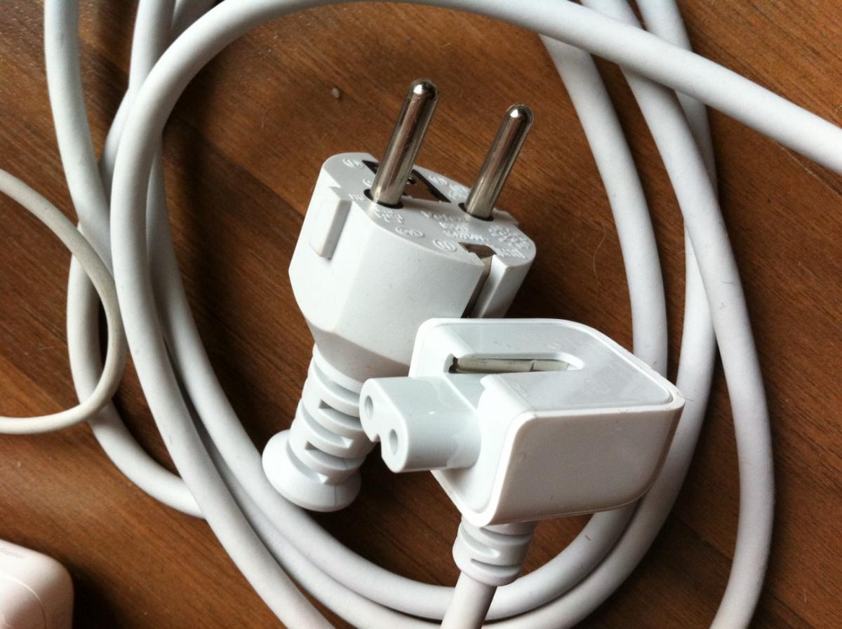

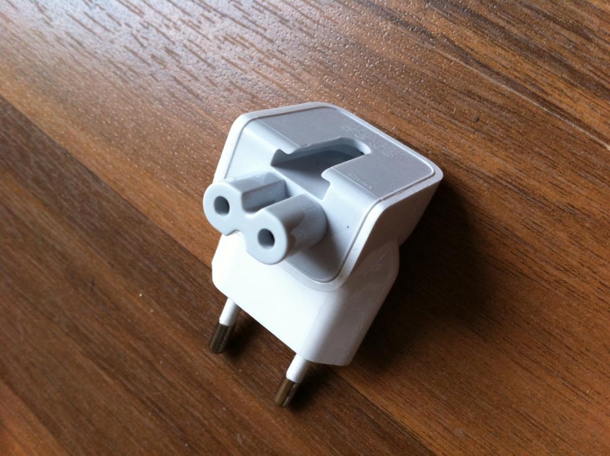

hmm … this made me wonder if this whole issue was related to grounding my macbook. So I tried the extension chord from my apple PSU, the one with three prongs (AC and Ground), and voila: When I use this I don’t have any more problems.
Seems that this is a common problem:
http://www.kellerbude.de/threads/1728-MacBook-Pro-Gehäuse-steht-unter-Strom-Spannung
TK, could you tell me which cable you used when you tested this? The three-pin (schuko) cable or the small two pin adapter?
