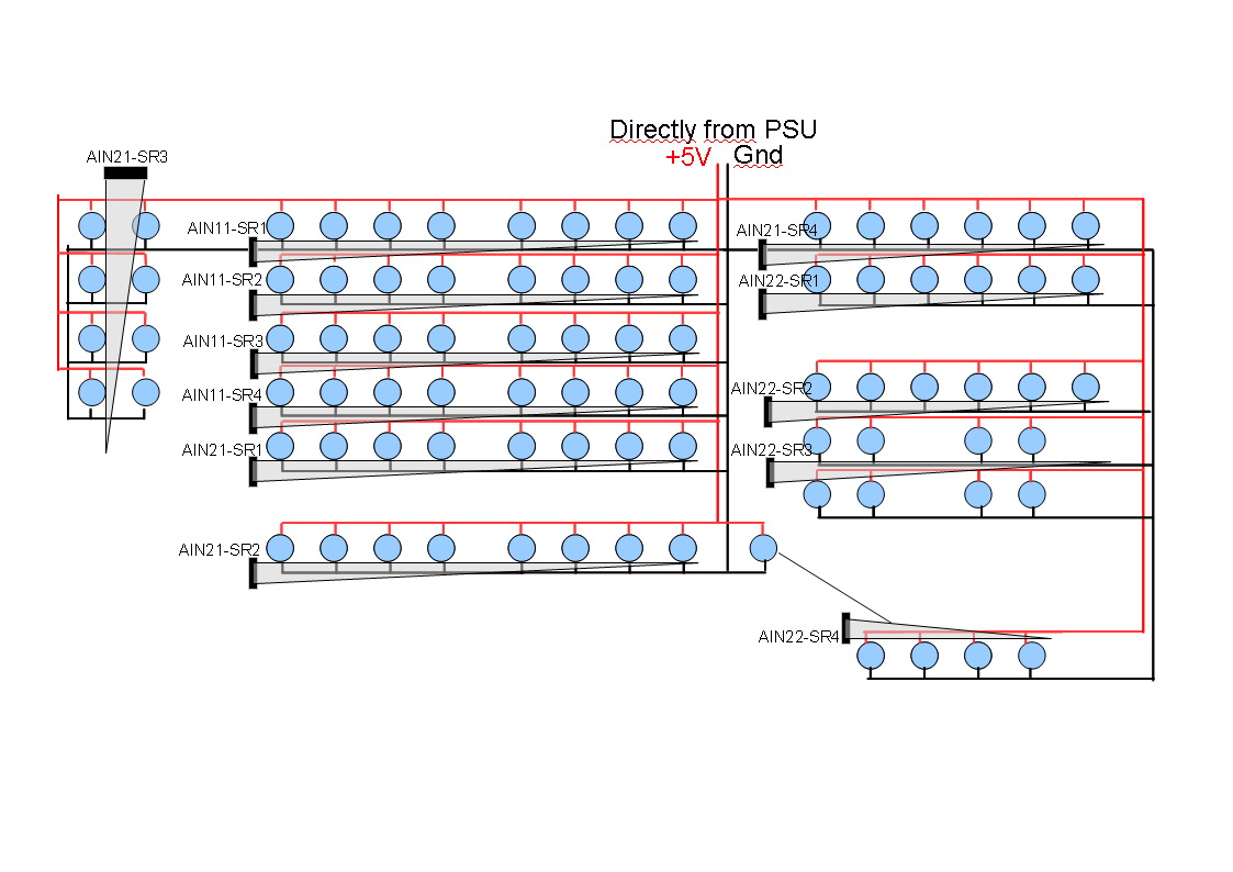

My last problem deals about AIN/pots.
Here is a schematic of the pots wiring of my protodeck (attached piece)
I have 2 core.
AIN are all AINx4 & are named like that: AINxy (x=core number, y=AINx4 number in the chain)
AIN11 is filled with 32 pots.
none problem with them ! nothing strange etc.
AIN21 is like shown on the schematic:
  • SR1: 8 pots ok
  • SR2: 8 pots
  • SR3: 8 pots
  • SR4: 6 pots + 2 pins clamped to GND
AIN22 is like shown on the schematic:
  • SR1: 6 pots + 2 pins clamped to GND
  • SR2: 6 pots + 2 pins clamped to GND
  • SR3: 8 pots
  • SR4: 5 pots + 3 pins clamped to GND
as I have to scan all pots in the chain, my MIOS_AIN_NumberSet(AIN_NUMBER_INPUTS); goes with AIN_NUMBER_INPUTS defined to 64.
strange things happens witj AIN21 and AIN22.
  • if I “touch” SR with my finger, or by squeezing corresponding flat ribbon onto them, randomly value appears… on pins corresponding
  • sometimes, when I turn pots on AIN22-SR1 for instance, 0 value is 0 (ok), I turn it … value increase, but decrease inconsistently and become 0  instead of 7F
  • the biggest problem is… it happens sometimes (I guess, when i touch flat ribbons connection to SRs) sometimes all seems very ok. but I need a more reliable deck
so questions are:
  • does my wiring seems to be VERY strange? (flat ribbon for values, red/black 0,25mm wires)
  • what should I test first? in second ? I  mean , a process to track that…
I checked my midilink, it works very fine: I mean, pots value from core1 (from AIN11) are VERY stable, reliable etc.
I checked 10 times my GND clamps… seems ok.
any help would be very appreciated!

Isolate the issue is your best friend. If you swap the connections from AIN->CORE around does the same problem happen on both cores? This is basically isolating the problem to be a core or ain issue. Then I would suggest if you can, swapping pots between AIN’s - this isolates the problem to a single AIN module. Also I would try swapping the SR’s around to see if the problem may be a flaky SR (not likely tho).
Did you solder the filter caps onto the AIN’s ? Some people like myself don’t seem to need them but others do, but it can affect things.
And don’t forget to power down any nearby Deathstars or particle accelerators whilst testing MidiBox…
(sorry) 8)
I changed all the AIN<>CORE cable by shielded one.
nothing has really changed.
I found one of the 4051 was freaky dead ! easy to isolate. I had doubt so I putted it at the end of the AIN chain and put the value of pots in main.h to 56 in order to let it for later… so now I 'm sure it is a dead component (or almost dead)
my PSU seems to be noisy (it is a switchmode PSU)
the proximity between pots wire (ribbon between pots and AIN) and PSU gives me big flow of false detections.
so I had around 2 problem, but one consequence: freaky flow of false detections.
indeed, by puttin the cable far enough from psu, I decrease the data flow false detection by an amount of 10000. really.
after that, I found sometimes little false detections, but only between very little range of values. I guess DEADBAND parameter could correct a little bit this. but it isn’t made for it, I guess (too)
