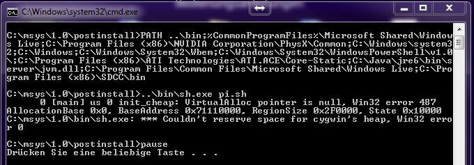

I’m on Windows 7 64-bit; Install of sdcc-2.8.0 works fine. When I want to install msys 1.0.11 the following error appears:
So what can I do?

OK, I will continue with this one. But can you tell me something about the error of the MSYS Installation?
Best regards, Beat
I’m not a Windows user… maybe somebody else knows why this can happen?
Best Regards, Thorsten.
That error occurs when you don’t run the command line as administrator.
