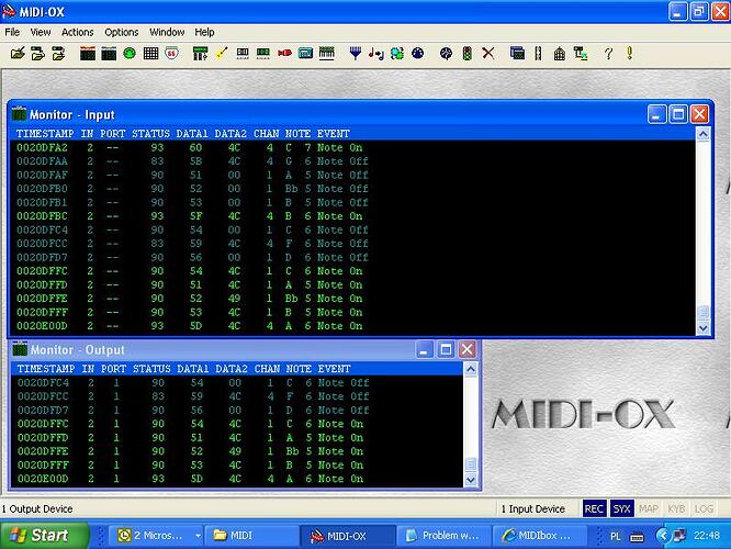

See screens, (MIDI OX)
screen1 - moment that it blocks
screen2 - after it is blocked
INPUT 1 - Channel 4
INPUT 2 - Channel 1

ok, only notes are sent. Meanwhile I looked through the code and noticed, that I added a timeout mechanism which prevents, that even uncomplete SysEx streams could lock up the MIDI forwarding.
But I also noticed, that a check for the OERR (Rx buffer overrun flag) of the internal UART is missing. So far I remember, the receiver won’t generate a new interrupt anymore on incoming MIDI data so long this flag stays set.
