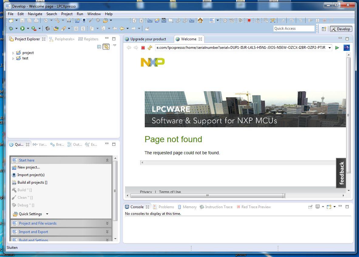

I found that in the Help menu but when I start the activation It goes to the website that gives page not found, I tried this many times but don’t work.
OK I have the stuff working! today I tried again the registration via my account on the website and after entering the serial I have got the activation code and now it works.
