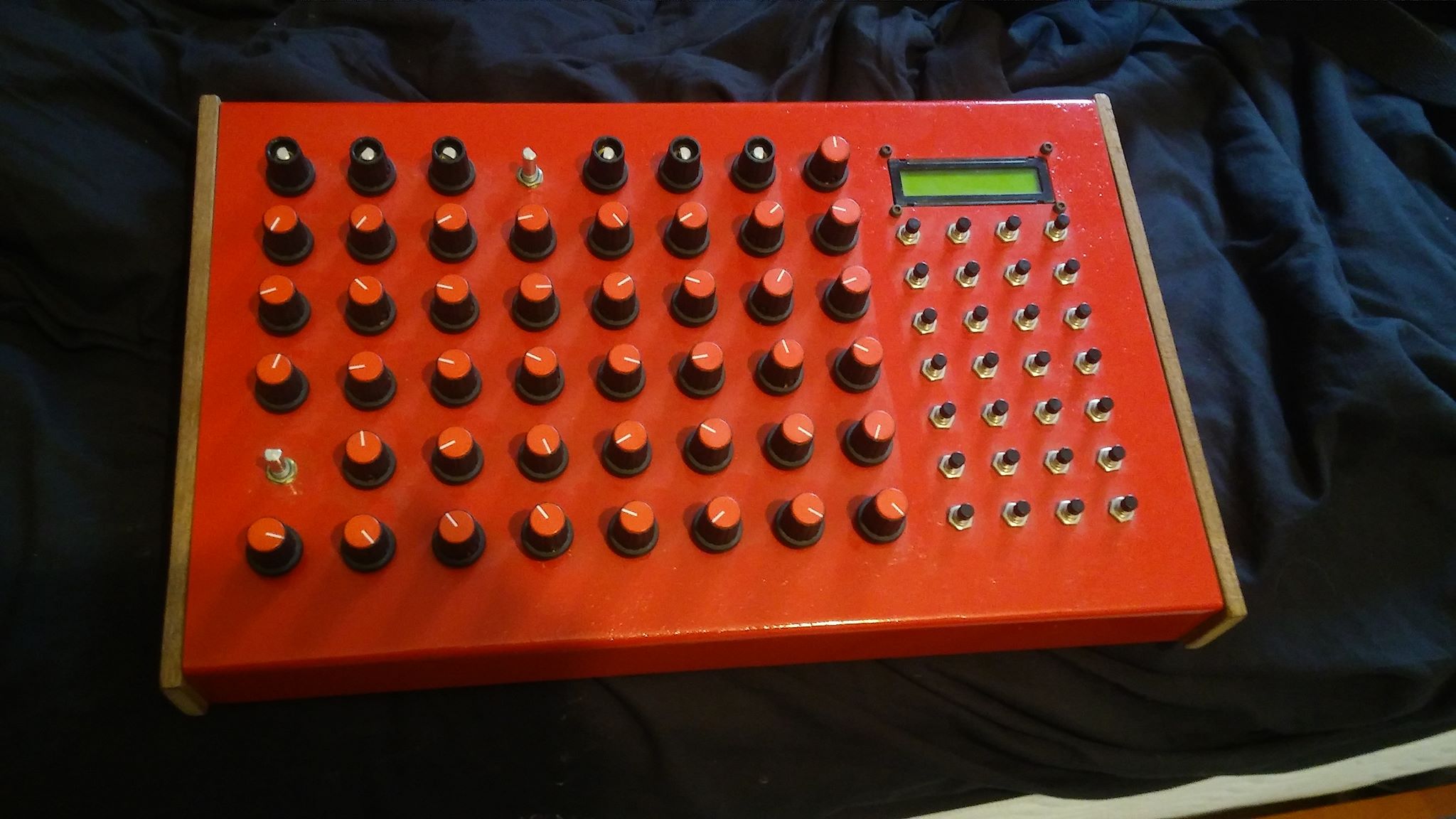

Hello there,
I got this attractive machine recently as a broken item but was able to “fix” it buy using a Euro 220v step up box.
So it works great booting up MIOS v 1.9.
But I have trouble understanding how to save and recall patches.
I can change the names of the knob settings and change the names of the banks but when i go to select patch the display just reads " < new patch A1 >"   on the first line of the display and the second line reads “Not in Patchmode”
Now effectively I can get by and use each of the 16 external banks as an individual patch but I would like to take full advantage of the potential of this MIDIBOX64 or …(possibly) MIDIBOX64e?
Thank you for any help.
S

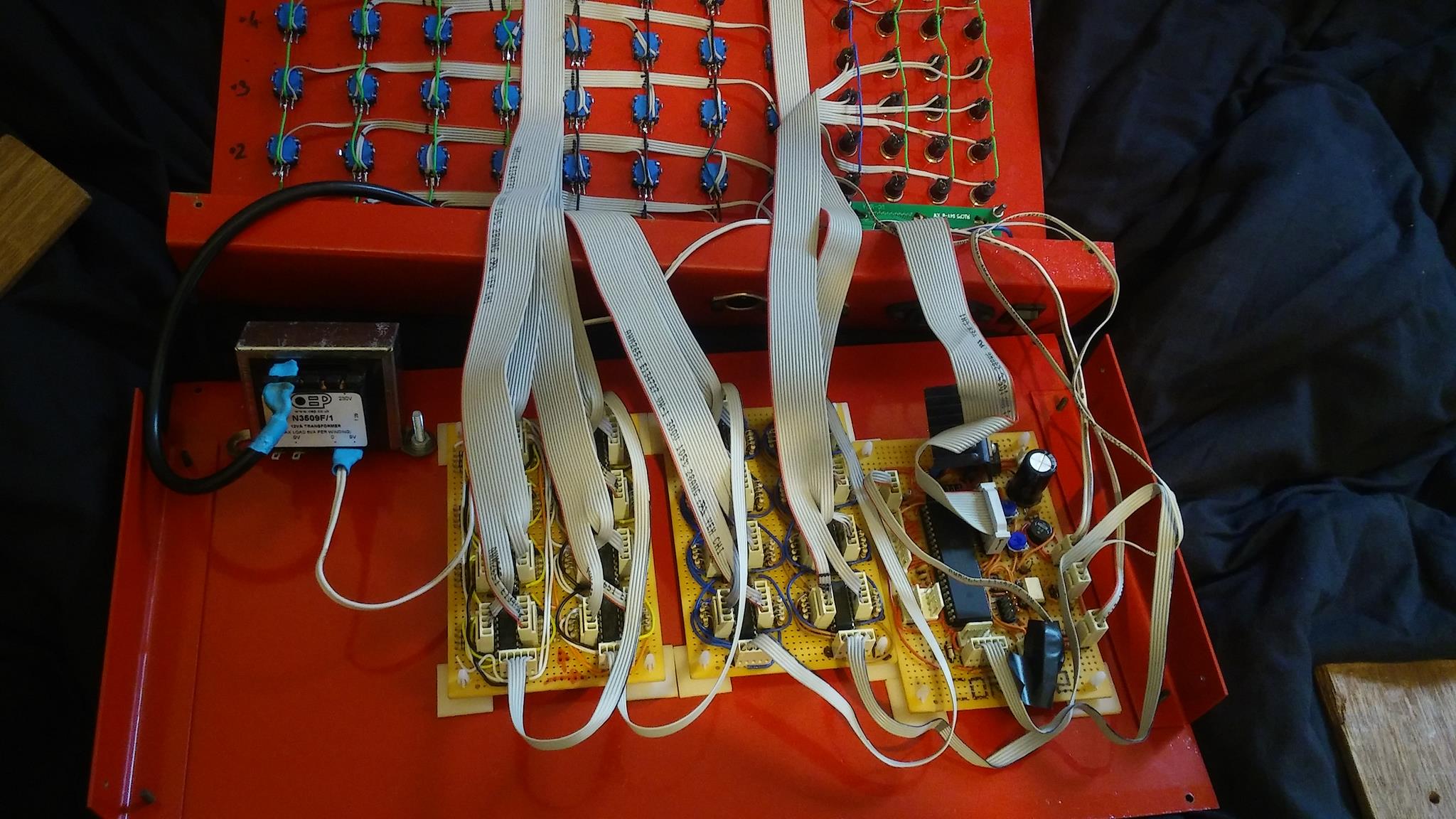

Judging from the wiring it’s probably an MB64E. You could upgrade to a 32-bit Core, then the configuration and patch storage is easily done with SD cards.
It does have one bankstick installed. The chip is wrapped in electrical tape in the lower righthand of the photo that shows inside. Hard to see.

I don’t know how familiar you are with electronics/MIDIbox etc., but what you have is a grid of panel mounted encoders and switches, which are scanned by shift register “modules” stuffed with 74HC165 chips. These form the SRIO chain. The Core is the brain of the operation, and newer generations are not only backwards compatible and easier to configure, but are faster and offer more hardware options (increased MIDI IO, USB, OSC/Ethernet, SD storage, etc.). It’s a whole new board though:

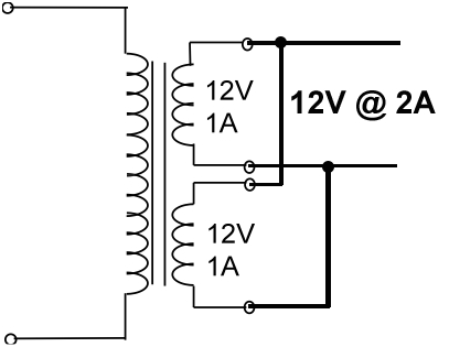

Just a little comment about the transformer. I guess you are located in the US. So you could replace it with a transformer which is suited for 115V. This would have been a cheaper option, but i guess that ship has sailed.
Second problem i see is that the transformer has two secondaries, but only one is used. This is not good. My suggestion would be to fix this by doing this:
Not sure if there are any fuses (i cannot see the mains connector) but if you want to make it safe(!) make sure the main side included a fuse.
