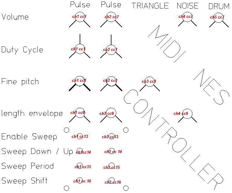

i want this shematic:

in few days i post my midinesmidicontroller in my nes.
here is a short picture.
