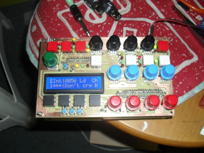

Hello!
I started building this structure. If anyone can possibly help it if a problem is it for me please.
25LC512 EEPROM writes to him, is a good 24Lc512??
Thank you very much!
Louis.

Hello!
Finished the great work! It’s just the problem. I could not even get him to speak. I do not want to sound. A vintage SysEx became our narrow passage loaded. Someone could help me? Only one sid/8580 / in it, but he also would not work?
Thanks for your help! Or what you need to program the EEPROM??
Finished the Twins! Have already said, only one expresses output and the other is completely silent. I do not know what could be the problem please help me me! The sid is good both because it is the same If you mix them with acsatorna. In the menu, I know the L / R channels but you can also set only one channel is about! How can I retrieve the memory of a SysEx hurt?
Thank you in advance for Louis.

Hello!
Can anyone help? Or because I can do that. If you have someone send it to me or post your ide.Most Vintage SysEx works, I’d like to spend another one in memory. Thank you! Louis.

Hello! Why should the Vintage sys file I can upload to memory?
Several people have tried but I can not! Why do help me! Thank you! Louis.
