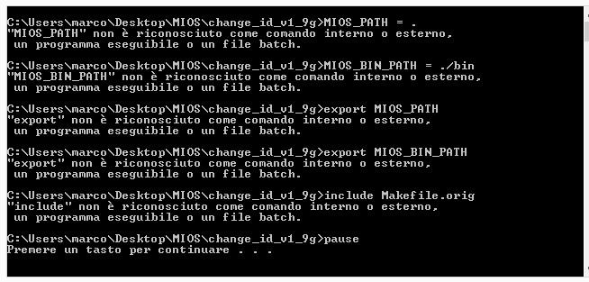

hello back with new info, in MakeFile.bat am,
MIOS_PATH =.
MIOS_BIN_PATH = ./bin
export MIOS_PATH
export MIOS_BIN_PATH
It includes Makefile.orig
the problem, I do not know what inpostare, and if you throw me the errors appear in the image.
please help me :sad: :sad: :sad: :sad: :sad: :sad: :sad: :sad: :sad: :sad: :sad:
