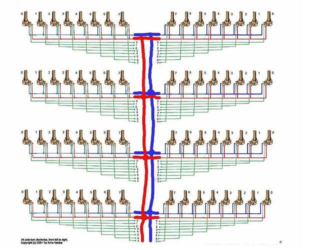

on this schematic:
I understand that if I watch my pots from a front view (soldering pins toward me) I have:
Gnd-Value-5V
is it right?
if it is, I’ll just wire like that  :stuck_out_tongue:
Yes, it’s right. Only , when mirrored text, pots connections looks like reversed.
Redrawing some lines for better understanding.
Regards, Janis
