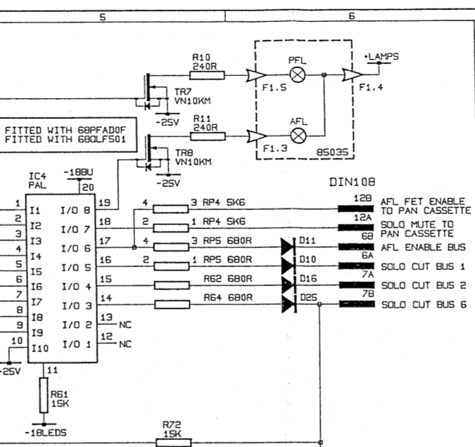

I would just use leds, but there doesn’t seem to be an easy way to remove them from where they are installed without breaking them, they are for the afl pfl switches from an ssl fader module ! .. There’s not really much information about what the actual ratings are for them, but I did manage to find them in this block diagram from the manual (top right):
Hopefully this provides a little more information on them.
Thanks so much for the help!
Looks like the lamps are already driven by some sort of line driver/level shifter. This is good, as one can lift the LEDs out and wire to DOUT that way. Considering the way they are connected, it seems like the 2981 chip will work better.
If “IC4” still works, another option would be to connect to its inputs. The driver chip looks quite strange; what is the part number on the IC?
Is the idea to use both the normal function of the mixer and something MIDIfied? Or is it a carcass just to build a controller?
Eh, I should read better…
Looks like there are already MOSFET drivers on the lamps. As they look biased to 25V, it seems that the 5V signal from a DOUT will not be high enough (did not check the transistor specs). But it could be tried with 5V supplied to the gate of TR7/TR8.
If you know what IC4 is, then the simplest way will be to match that voltage as driven from a DOUT. Please post the whole service manual if possible.

ep320pc-2 is the part number for that ic http://www.datasheets360.com/pdf/-3584855117084061587
This is not LED this is filament lamp, they are in the button, depending of manufacturer you should be able to remove the top transparent caps and have access to the lamp, is that EAO switches ?
If they are T5.5 filament you can replace them with LED (available in T5.5 package)
I guess they are 24V rated, +LAMPS in the schemo should be a separate 0V/GND for all lamps, as the -25 dedicated rail for “power” light

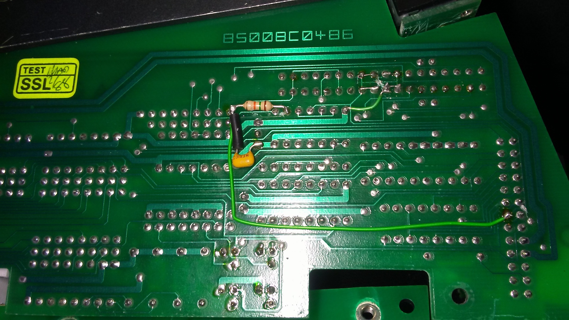

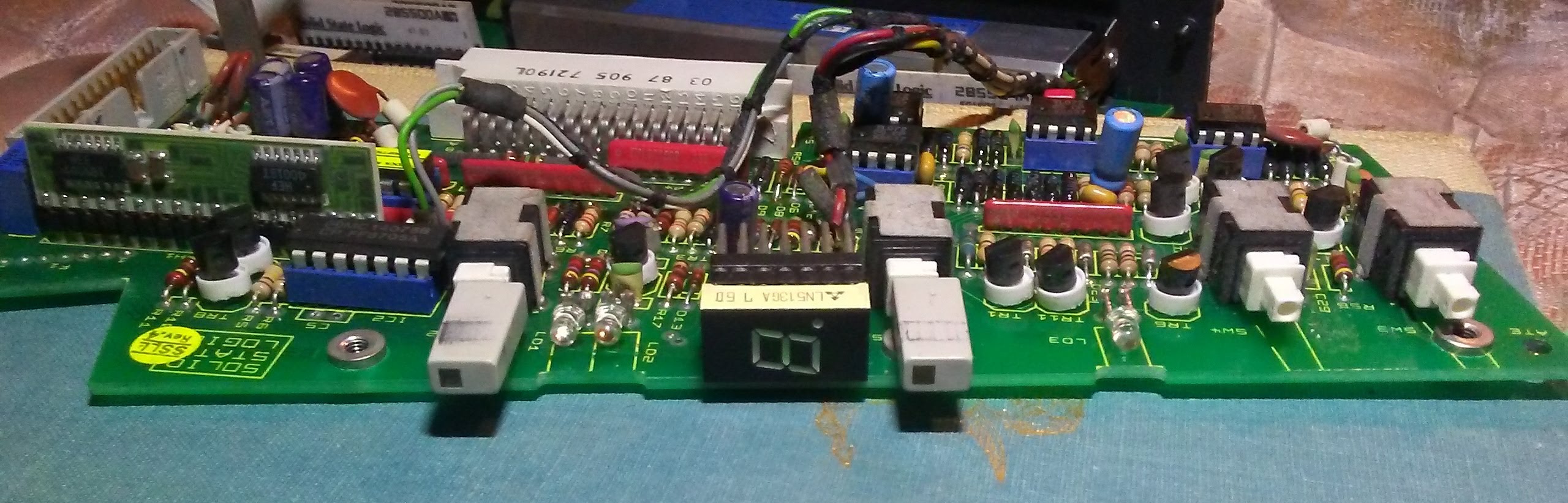

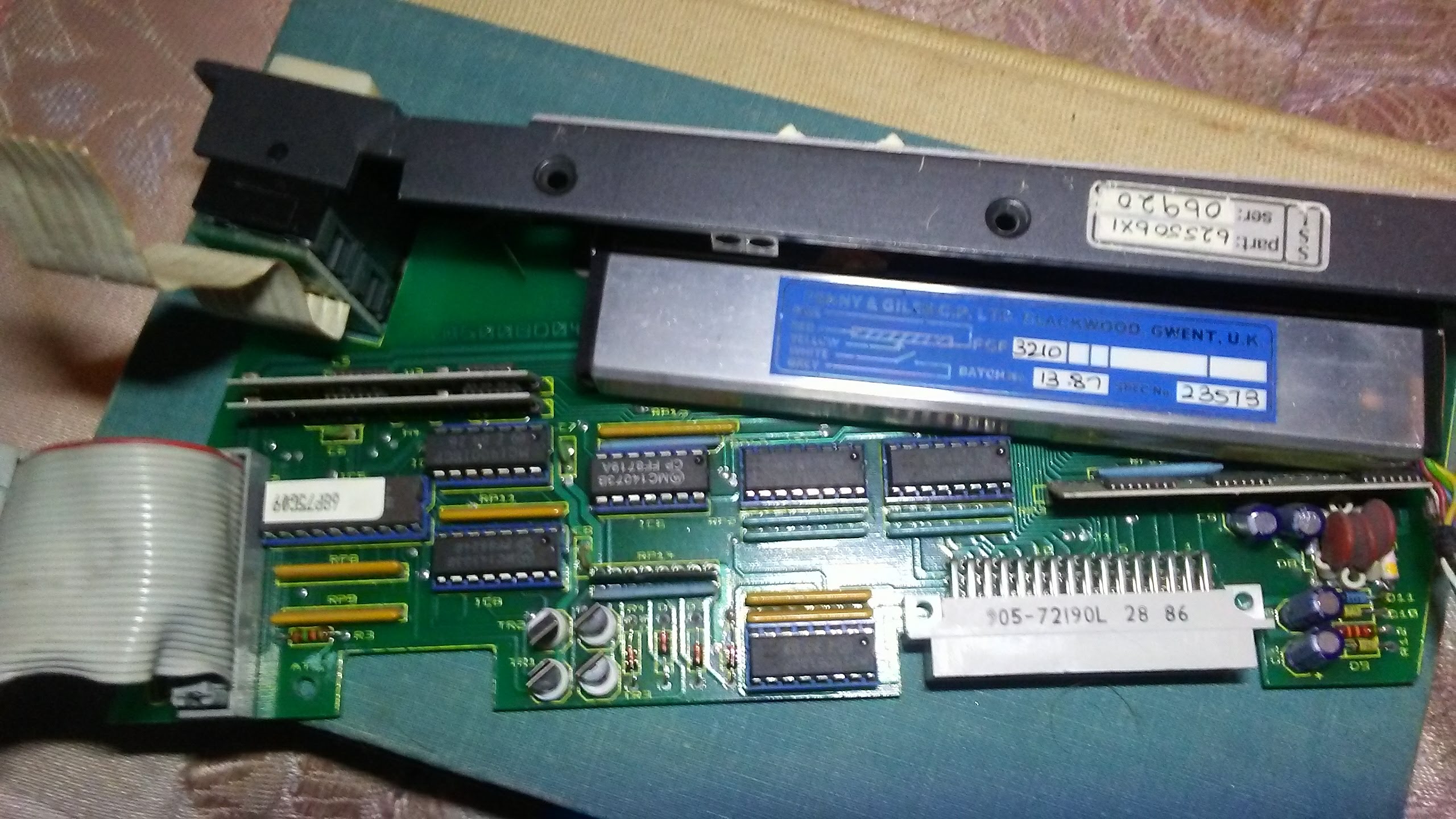

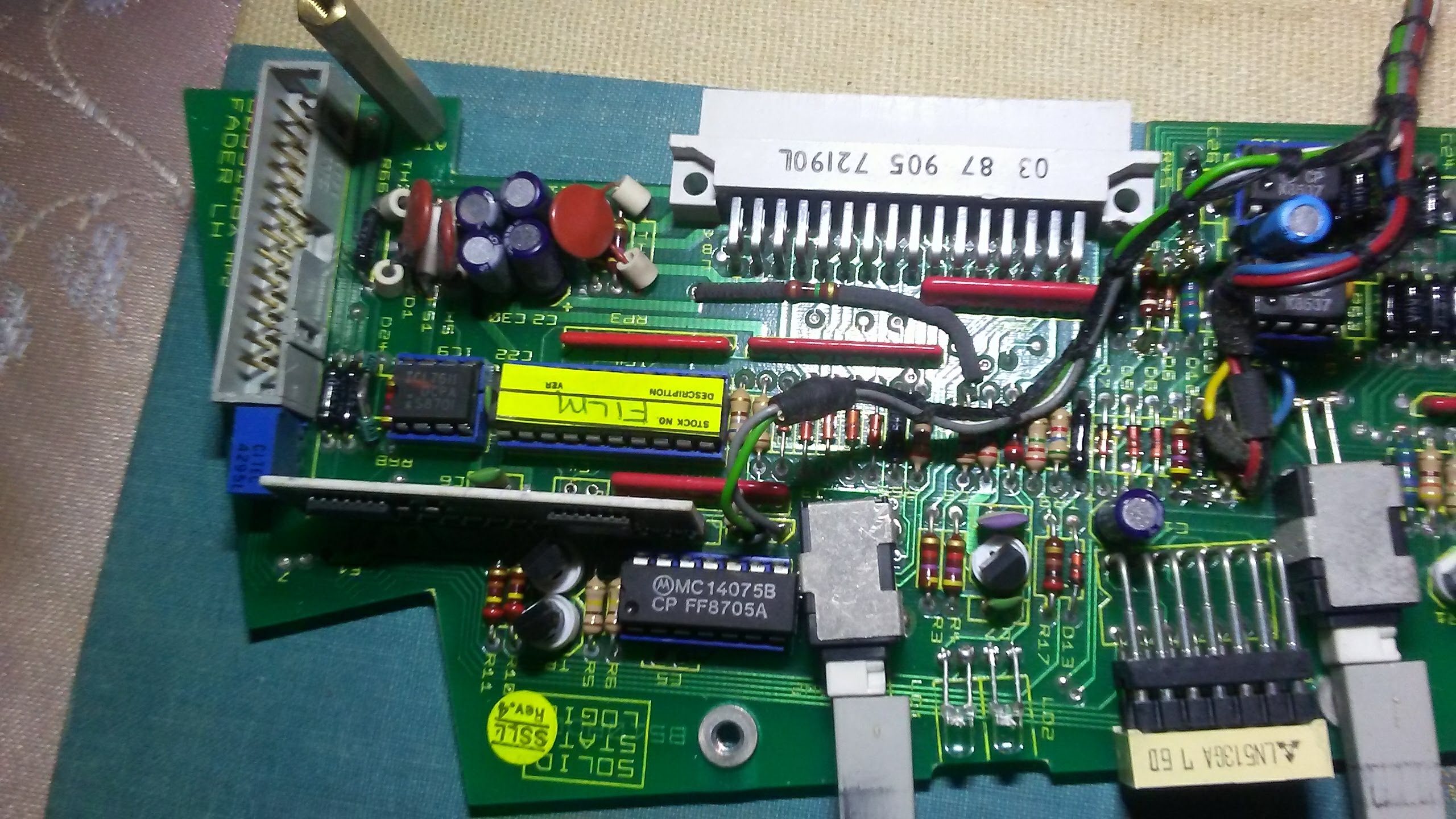

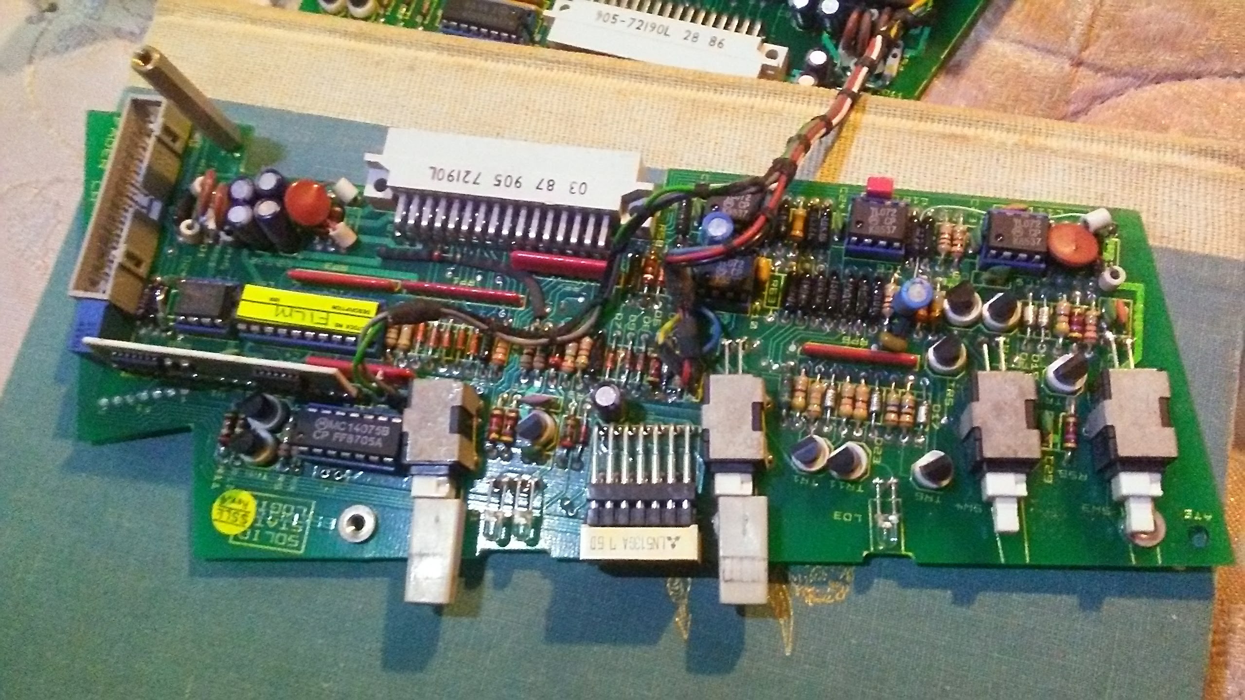

I’d be glad to share, there are two pcbs on either side, connected with a ribbon cable on top
All of the modules I have are the same model sl506, but are all configured differently it seems, they all have these different mods on the outsides of the pcb
On this one, the same “ic4” I posted earlier has a sticker with the word “Film” on it. They are from a 5000 series which i know were meant more for broadcast and post production. so maybe this was more formatted for film?
Another interesting thing is the two extra buttons at the bottom. The sl506 doesn’t have two bottom buttons on the front panel, but other 5k series faders do, so manufacturing-wise they didn’t omit the switches based on the fader model, just the fader caps. There are even the leds inside, I know because I applied power to them and they lit up ! I’m guessing that later, they would make modifications by hand based on how the customer wanted their console configured, but it is all a mystery to me really
Also sorry about the quality, I can try to take some better pictures, I just have the camera on my phone
