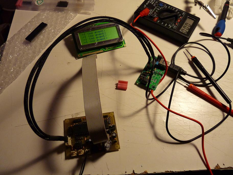

And here are some pictures with the core running the midimon app and the opl3 module :slight_smile:
Finally I can hear some sound from mbfm! :frantics:

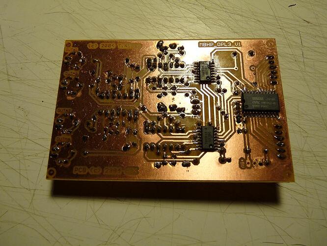

Bipolar psu and opl3 module
The “family”
