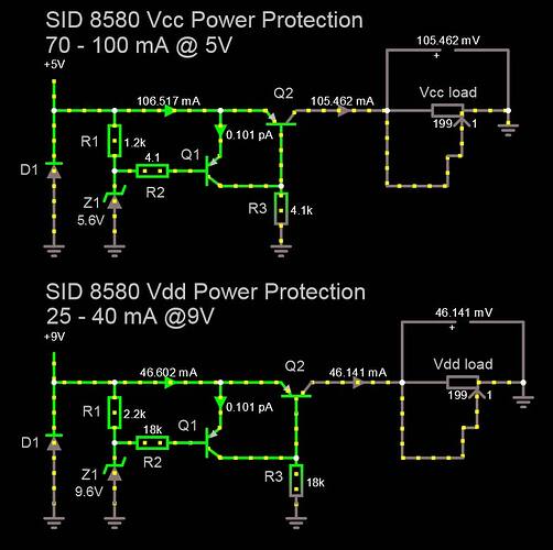

I’ve simulated the circuit and carefully selected the components so that they meet the 8580 Chip
Power limits specifications. I actually took this info from the 6581 datasheet, so not really sure
if the same values apply, but good enough to use as a case study.
6581 Vdd pin = 9V   25 - 40 mA
6581 Vcc pin = 5V   70 - 100 mA
I’m using 2 separate circuits in my simulation, one as a protection for the SID Vdd pin, the other for the Vcc pin.
Here is the outcome of the following tests:
Test 1 : Ideal conditions - sim001_stable.jpg
I feed the expected voltages(in range) into the circuits, using some moderate loads (around 200 ohm) to pull some current  and everything works as expected.
The pass transistor Q2 passes the amount of current required by the 200 ohm load, but also imposes a small voltage drop on the line so this should be taken into consideration.

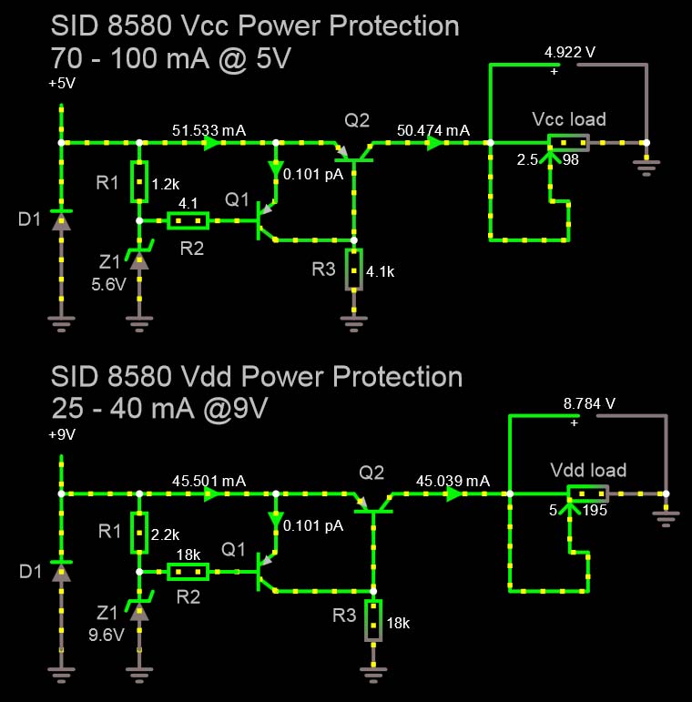

Test 2 : Over current protection in action - sim002_heavy_load.jpg
I started to simulate faulty conditions. First I decreased the resistance of the loads progressively until I reached their smallest possible value (around 1 ohm), so that maximum current is pulled from the pass transistors Q2.
After the load resistances goes lower then a certain value, the current through the pass transistor Q2 is kept the same, and does not go higher as it is limited by resistors R2, R3 and transitor Q1 which controls the current flow in Q2.

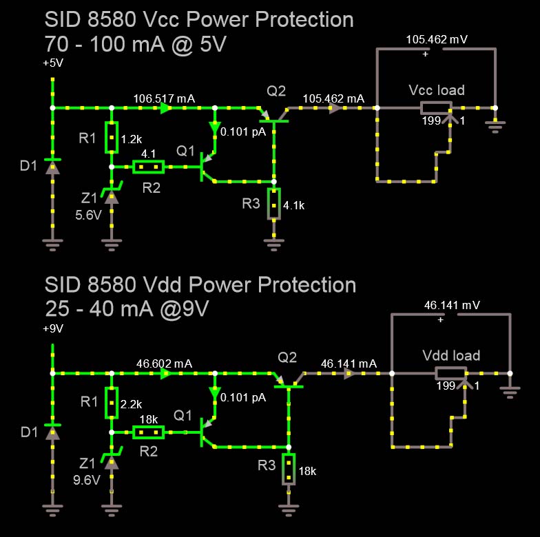

Test 3 : Extreme limits near tip off - sim003_heavy_load_over_volt.jpg
I started raising both Voltages at the circuit inputs until near their tip off points.The load resistance level was kept the same, so that maximum current flow is expected.
In this scenario we can see the maximum current that the circuit will allow to pass, just before its tip off point.
For Vcc, when there’s a slight over voltage condition, the maximum allowed current will be around 20 mA more then its rated max limit of 100mA.
For Vdd, when there’s a slight over voltage condition, the maximum allowed current will be arounf 10 mA more then its rated max limit of 40mA.
This upper limits are carefully set as to provide some wiggle room for the IC current requirements.

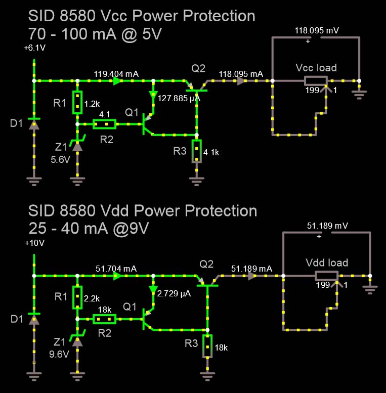

Test 4 : Over voltage protection in Action - sim004_over_volt_shutdown.jpg
I continued to raise the input voltages above their tip off points (6.2V for Vcc and 11V for Vdd).
Once the input voltage exceeds the tip off voltage, the circuit cuts off the pass transistors shutting down the power lines to the IC pins.
The transistor is kept off until the input voltage level is set lower then its tip off point.
