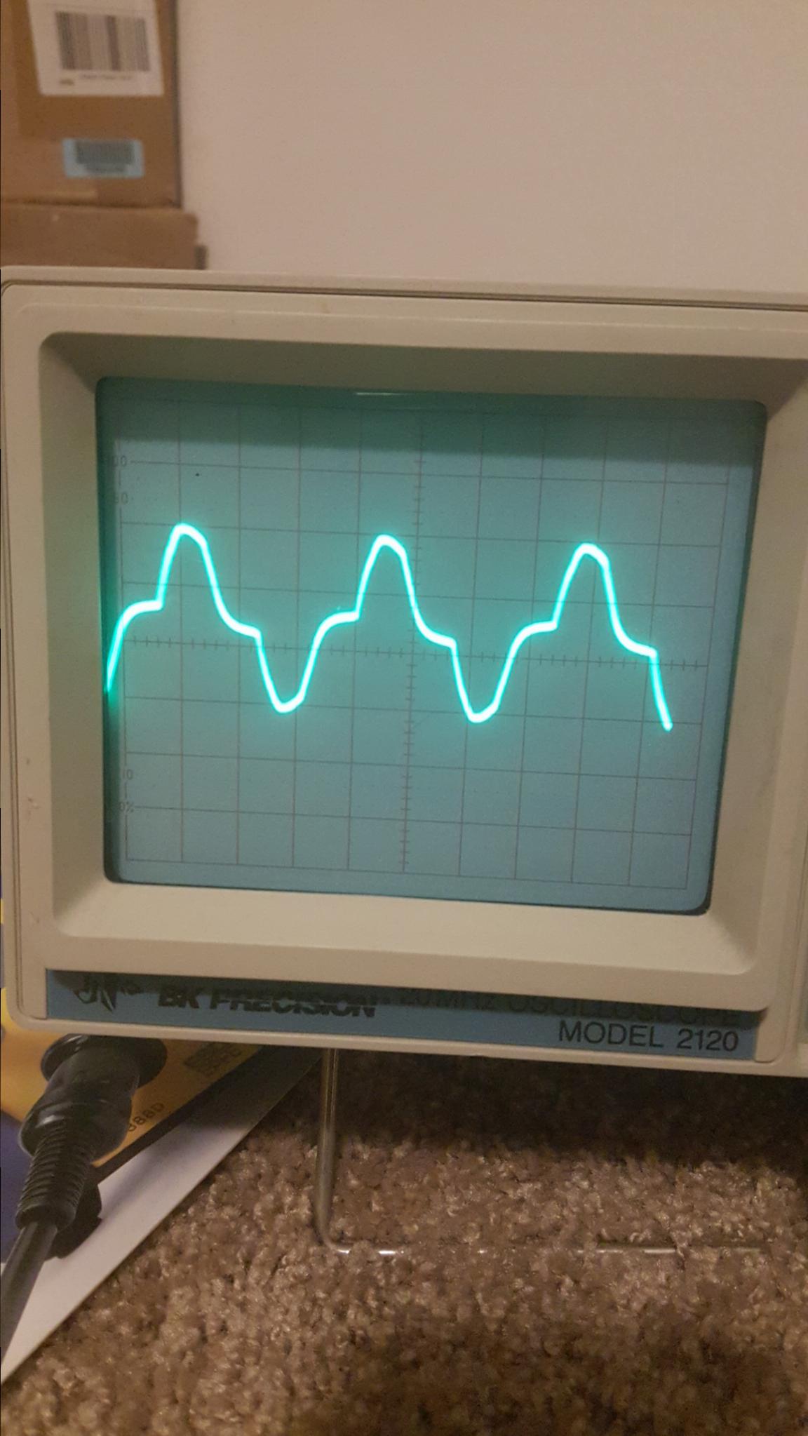

Could you plot your 9/12V inputs by scope and send a picture? It will show the input signal,if not well regulated or whatelse.

The scope is showing a straight line on all rails. Even the 5v rail I cannot see a waveform, however, I test the 5v rail and all the sockets with a multimeter and it is supplying the 5v.
I’m testing from the test point pin headers.
I tested the 9v and 5v pins on the power supply and took screenshots of those.
