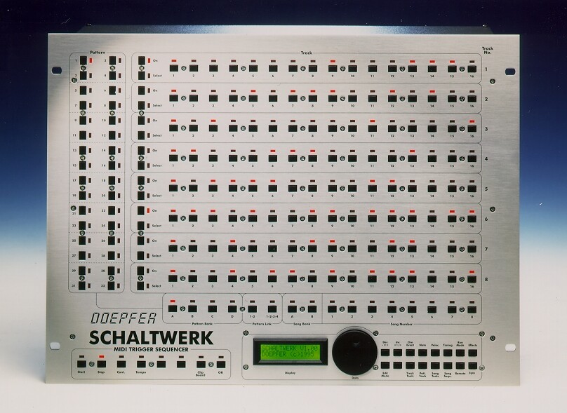

will MIOS support a midibox seq similar to the doepfer schaltwerk or the genoQs octopus?
I count about 218 digital inputs and 200 digital outputs on them

The OS (MIOS) will, but someone would have to write the application
is it even possible to have more than 128 digital inputs on this sequencer project?
Yes, you can use a matrix, but you’ll need some programming skills, nothing of this nature has been attempted as yet with TK’s sequencer.
I’m assuming I would need more than one core
Possibly, although this would be more about utilisation than IO restrictions.
and something like 8 DIN boards and 5 DOUT boards…
Nah, use the matrix :slight_smile:
I’m also assuming I would need to extensively edit one of the setup*.asm files
Sorry mate there’s a lot more involved than that… You’d need to make major mods to the application’s control surface code.
There was a rumour of a button matrix like the monome for the upcoming version of the seq, but that is not released, and it will be ready “when it’s ready” :slight_smile: But if yuo pay attention yuo may catch some teasers :wink:
