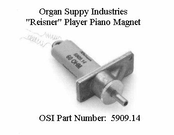

Is your player mechanism purely pneumatic, or does it have have electromagnets?  If it is not electrified, Organ Supply sells player piano magnets.
The MIDIO128 app should work just fine for your piano. Positive/negative pressure doesn’t make any difference electrically.  Look into this-
