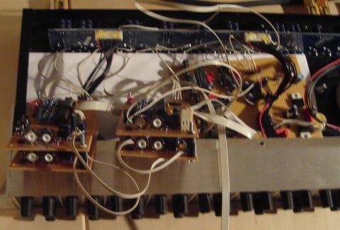

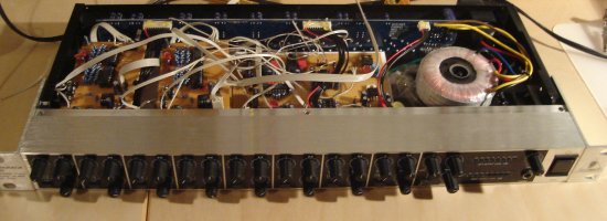

Since months I was thinking about a nice housing for my 4 CEM3378 filters and AOUT_LC modules. Finally I got the idea, that nothing would be easier than just to integrate the modules directly into a mixer. So, I opened my “Eurorack” linemixer from Behringer and was very happy to find enough room for all the boards:
As a nice side effect, the PSU is already there. It delivers +/- 15V. I’m using a 7905, 7805 and 7812 to regulate the voltages.
The AOUT_LC module is supplied with +12V/-5V (+12V to get enough headroom for the filter CV). Two modules are stocked for best utilisation of the available space in the mixer case:

It is for the CEM filters, and as the negative voltage is available, I’m also using it for the AOUT_LC module.
The CV inputs (of the *external* CEM3378 circuitry -> see datasheet) are working in a range of ca. 1V-7V (CutOff) and 0V-3V (Resonance). In addition to the gain/offset trimmpots of the AOUT_LC module, I’m using 10k trimmpots against ground at the filter CV input side - all 4 AOUT_LC modules deliver the same voltages when the CVs are swept from min to max, and with the additional 10k pots I’m able to fine-adjust the desired maximum resonance and I equalize the CutOff frequencies of all filters on an easier way, than with the non-linear gain/offset pots
