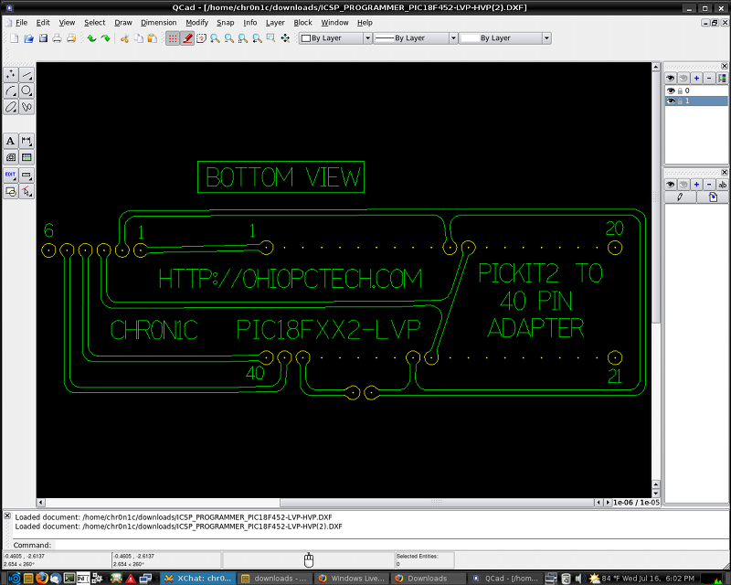

picture of my schematic for the DIY icsp programming adapter is attached below. it uses an ic socket, a 6 pin header and 5 short lengths of stripped out cat5 cable… the schematic would be looking at the board from the bottom (single sided etched pcb) (short the jumper on pin 38 to make it work right)
EDIT: scale the layout so the pins are 0.100" apart if you are going to etch it!

Me being (sorta) new to the whole pic programming thing… i get confused easy with all the terminology. seems as though my programmer will do either mode and the pic i am using was programmed in HVP with the adapter i made as long as the jumper in my schematic above is connected.
stryd_one, thanks for pointing out my mistake in the post.
short story, you can use a pickit 2 and my adapter to program a pic for midibox.
