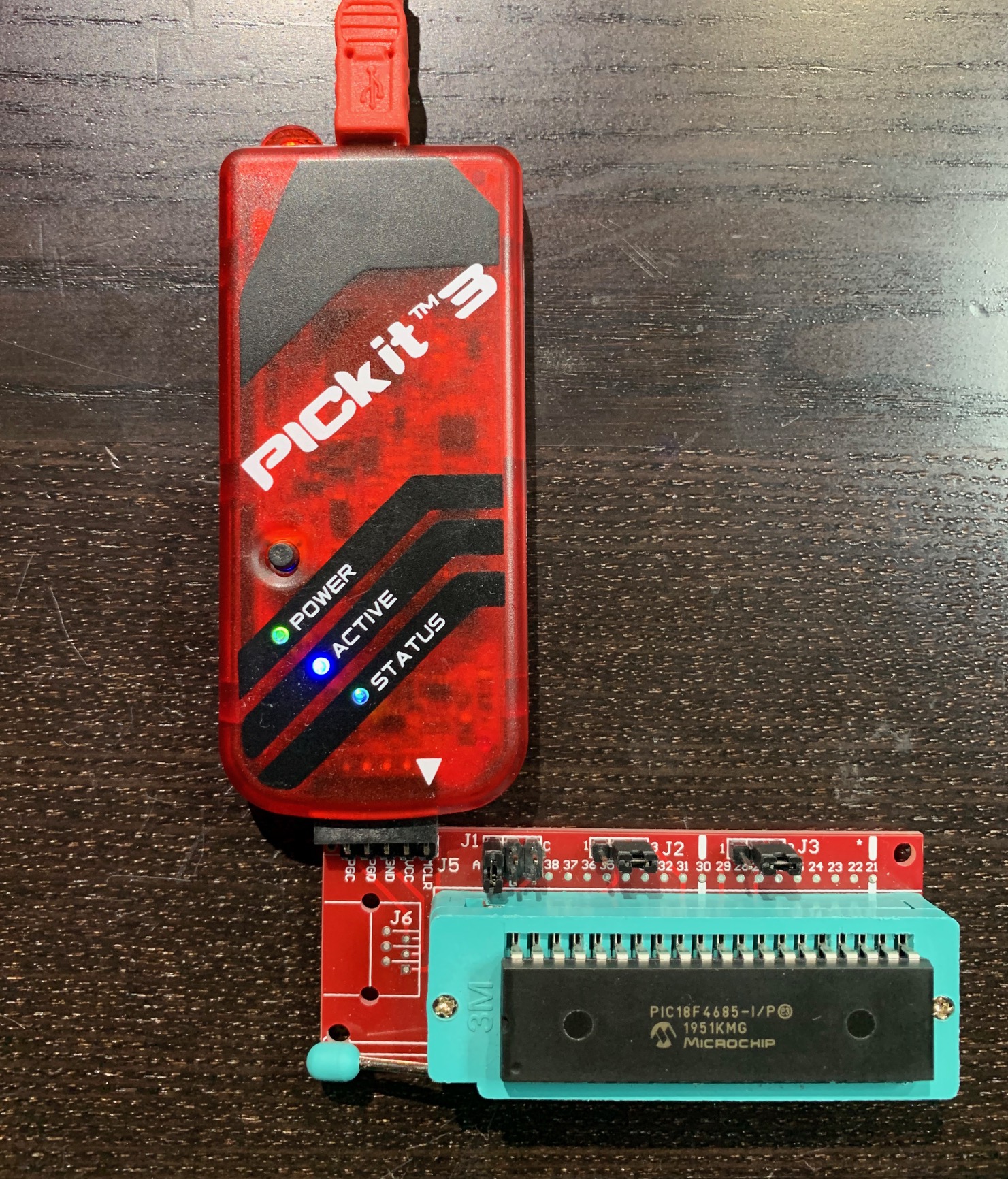

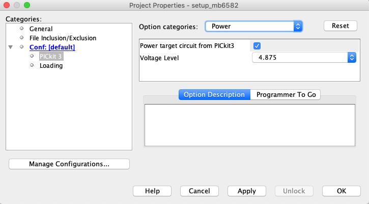

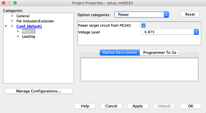

I finally got my PicKit 3 working in MPLAB X IDE.
I needed to manually configure the Pickit to supply source voltage to the PIC.
Interestingly it failed when I supplied 5V, but it works perfectly and consistently with a little less (i.e., 4.875V).
So now I’m able to burn the setup_mb6582.hex files, which uses the memory range 0x3000 to 0x17fff, but I seem to missing the boot loader code?
Appreciate any suggestions and guidance…
