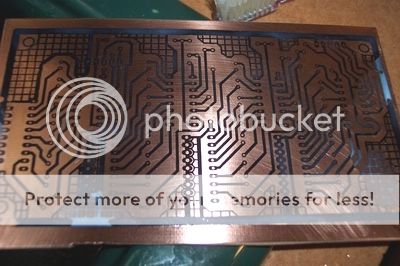

Here’s some iron-on stuff from this weekend using the Staples paper-
The little nicks and couple pinholes in there were actually part of the print. I’m using an HP LaserJet6L, which prints pretty dark. I normally go around and re-mask thick areas on the outside border lines and stuff with a marker if it’s important, but this board was more for practice.
Here’s a shot of the etching (which sucked BTW- I was using some exhausted ferric chloride with poor heating and agitation and even had it in sodium persulfate for a bit).

Though you say that board sucks, it’s way beyond mine.  I actually have the same kind of laminator that Pulsar recommends, and I got broken traces with feathery edges.  And that was when I could get the toner to transfer cleanly in the first place.

No, I like that board alright. It’s more that the etching process sucked. I think overall, I was hanging out with the chemicals for over a half hour. Neither mix was in usable condition. The Sodium P. was old and was a poor mix to begin with, and the FC was just too old and weak/watery. For a while, I felt like I may as well have dunked the board in some chicken soup.
I built a nice etch tank a while back and haven’t been using it because it requires too much etchant. With the heat and bubblers, that thing did a clean etch in a few minutes, even with old nasty watered down FC. I want one of those coffee pot etchers, but if I ever get off my a$$ and get a roll of that green TRF, I may start doing the “wipe etch” thing, which seems perfect for small one-offs. I also want to try that etchant mix that Gootee praises on his site (hardware/drugstore stuff).
