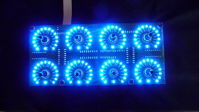

The camera have created a “halo” all around each LED which doesn’t exist.

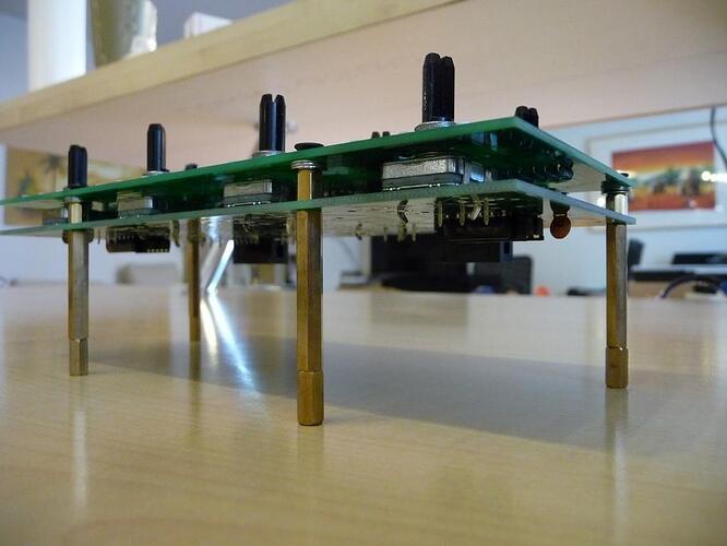

This is the minimal height I found to stack MB-E4x2CS & MB-LR4x2CS (here =7.5mm).
Best would have been 6.5mm (encoder base height).

With 25mm shaft encoder (I haven’t yet received the samples) it should be perfect.

…At least no brightness problem with blue LED !!!
MB LR4x2CS 6
Stand-off=6mm.
Nuts=3*0.5mm.
Total height=7.5mm.

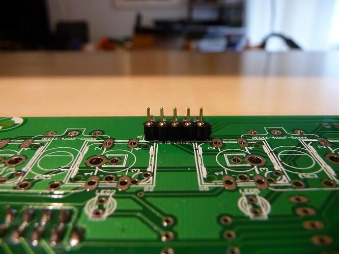

Round male pinheader.
MB LR4x2CS 1
MB LR4x2CS 2
MB LR4x2CS 3
Female round pinheader.
Re: MB E4x2CS&MB LR4x2CS 11
…the reason why I bought about 500 blue leds from China guy :smile:
very very nice fairlightiii
How are under artificial light ?
There’s a big windows at approximately 1 meter of the board in the latest pictures I posted (natural light).
I will try ASAP to make others pictures with direct artificial light .
But I think that my camera doesn’t* *make justice of the boards (mostly the blue one): The blue light is sharper than in pictures.
