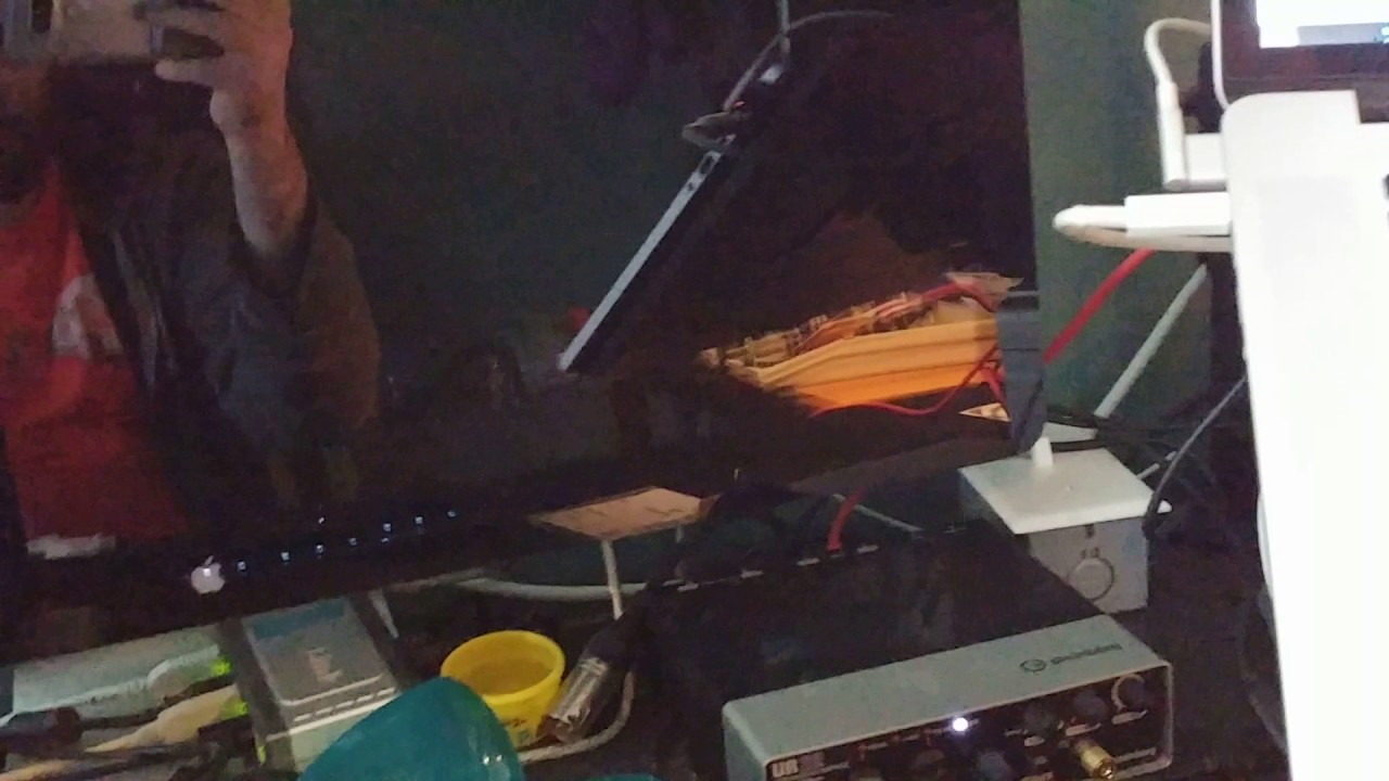

Hi all, so I finally got my MIDIbox SID playing notes yesterday, which was quite exciting, but I did notice that when I pressed a key, after KEY OFF I could still hear the note, albeit much quieter.  Here’s some video I shot with the issue:
Is this what http://www.ucapps.de/midibox_sid_manual_ki.html is referring to when it says “oscillators are not completely silent once a note has been played”? And when it says its a bug, does that mean all SID 6580 chips do it, or that its random?
Note: I haven’t connected Audio In to ground, but I assuming not doing that results in noise or a hum and not notes.
