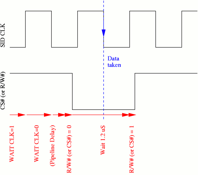

Today I made some experiments with SID bus transfer synchronization - since I’m not sure if the proposed solution works properly in all cases (e.g. independent from cable impedance and ambient temperatur), I’ve modified the SID bus driver in sid_sr.inc, so that it takes care for the falling clock edge, at which the data will be taken. Here a diagram (for people who are still interested…)
This old code in sid_sr.inc:
        ;; initiate a write and wait for 1.4 us (> one clock cycle)
        bcf    SID_SR_LAT_WR, SID_SR_PIN_WR
        movlw  0x03
        clrf    MIOS_PARAMETER3
SID_SR_WriteLoop3
        incf    MIOS_PARAMETER3, F
        IFNEQ  MIOS_PARAMETER3, ACCESS, rgoto SID_SR_WriteLoop3
        bsf    SID_SR_LAT_WR, SID_SR_PIN_WR
[/code]
has been replaced by:
[code]
        ;; synchronize with rising edge of SID clock to avoid setup or hold violation
        ;; note: due to pipeline effects, the "bcf" will be executed 3 instruction cycles after
        ;; the polling loop. Therefore we are waiting for the falling edge
        IFCLR  PORTC, 2, bra $-2              ; wait for falling clock edge
        IFSET  PORTC, 2, bra $-2
        bcf    SID\_SR\_LAT\_WR, SID\_SR\_PIN\_WR    ; enable write (MBHP\_SID: chip select)
        bra    $+2                            ; to ensure compatibility with on-board oscillator,
        bra    $+2                            ; wait for 1.2 uS (\> one SID clock cycle)
        bra    $+2
        bra    $+2
        bra    $+2
        bra    $+2
        bsf    SID\_SR\_LAT\_WR, SID\_SR\_PIN\_WR    ; disable write (MBHP\_SID: chip select)
Now it looks perfectly at the scope! Now the practice test starts - if I don’t notice failures anymore, I will publish the required changes (and the updated firmwares) at my website

Yup,
in the current setup it’s the only way to ensure PIC -> SID data transfers are in sync.

Not really - but remote diagnosis is difficult without knowing your hardware setup + software.
The effect happened sporadically when a free-running (not synchronized) oscillator was used; conclusion:
a) the SID clock shall be generated by the microcontroller
b) each write access to a SID register shall be synchronized to the SID clock as described above to avoid timing violations.
If the effect always happens, it could also be related to your hardware setup.
E.g. defective SIDs, wrong voltage, wrong filter caps.
Best Regards, Thorsten.
