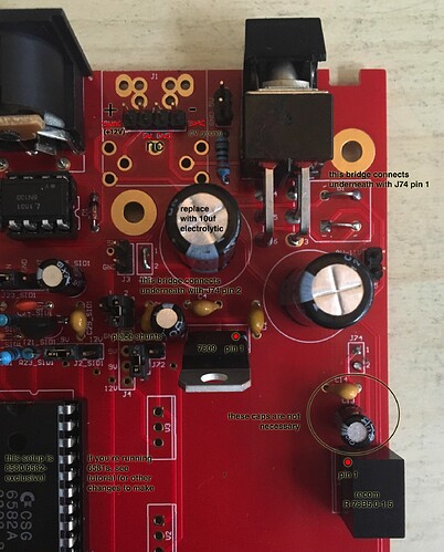

PSU OPTION E
  • Jumper pin 2 and pin 3 of J71. This connects V1 common pin to ground.
  • Jumper pin 2 and pin 3 of J72. This connects V1 output to 9V rail.
  • Jumper pin 1 and pin 2 of J73 and pin 2 of J74. This connects the output of V4 to 5V rail (as well as a few smoothing caps). If you take a look at my photos, you can see I used just one piece of wire to jump all three pins—a short, uninsulated section on the top of the board to jump J73 pins 1&2 together, with a longer, insulated section underneath the board between J73 pin 2 and J74 pin 2. I felt that this was the cleanest possible installation, as it keeps all extra wiring on the solder side of the board. However, you may find it easier or prettier, especially if you’re modifying an already built MB-6582, to wire up slightly different points. Check out Altitude’s photos in the old thread for an alternate wiring scheme, or follow traces on the PCB (nice diagram here: http://www.midibox.org/dokuwiki/lib/exe/fetch.php?media=mb-6582:mb-6582_base_pcb_r2_color.pdf) to come up with your own.
  • Jumper the “~” and “+” pins of B1 (the two pins closest to S1; see photos for clarification) and pin 1 of J74. Just like the previous step, you can use one piece of wire to jump all three points and keep the top of the board looking clean, or choose your own wiring scheme according to your needs.
  • Jumper the “-“ and “~” pins of B1 (the two pins closest to C1; see photos for clarification). Important note: there are two pins on B1 labelled “~”. Pay attention to which one you’re bridging to where. Look at the photos!
  • Install V1. Pay attention to pinout. The square (rightmost) pad is pin 1 (input).
  • Install V4. Pay attention to pinout. The square (bottommost) pad is pin 3 (output). (If you’re curious why, go back and read that technical note you skipped earlier in the tutorial.)
If you want to use only 8580/6582 SID chips, you are done!
Make sure all your SIDs have a shunt installed at J1_SIDx and J2_SIDx connecting them to the 9V rail and you are good to go.

Here are some images. Sorry the text turned out so small, you will probably have to click on the image and display it full-size to read it.

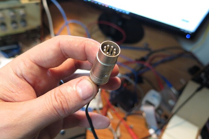

One thing that would also be worth adding is how to wire up the 7 pin DIN socket, the way I did mine is to simply get one of the Rean 7 pin DIN connectors and use that

That’s a really good idea; I actually haven’t figured out that part of my build yet. I had actually planned on connecting J1A to a panelmount barrel jack so I could use a standard wall-wart without modification. Upon investigation, however, the placement of J1A interferes with the obvious placement of the barrel jack on the rear panel. So I may end up putting a 7-pin DIN on a wall-wart, as you’ve done.
Either way, once I have a permanent solution, I’ll take pictures and add it to the tutorial.
Hi Altitude,
did you tie a knot on the cable inside the strain relief for the DIN connector to help take force away from the solderd joints if one tugs on the wires insted of the connector?
Luckily i have 2 neutrik DIN connectors i bought when stocking up for mb-6582 build in case a day like this ever came, I love when extra components lying around become needed.

I use moisture seal heat shrink (it has glue on the inside) which grabs the cable VERY well, then I just use the strain relief built into the Rean DIN jack
Ooo thats even fancier! Do you have any online link for the heat shrink you used?
Maybe something like this but a smaller diameter?
http://www.newark.com/te-connectivity-raychem/atum-16-4-0-stk/heat-shrink-tubing-16mm-id-po/dp/41J2177
that looks right, I used 11/32", you want something big that results in a large diameter to make up the for the small size of the DC power leads.

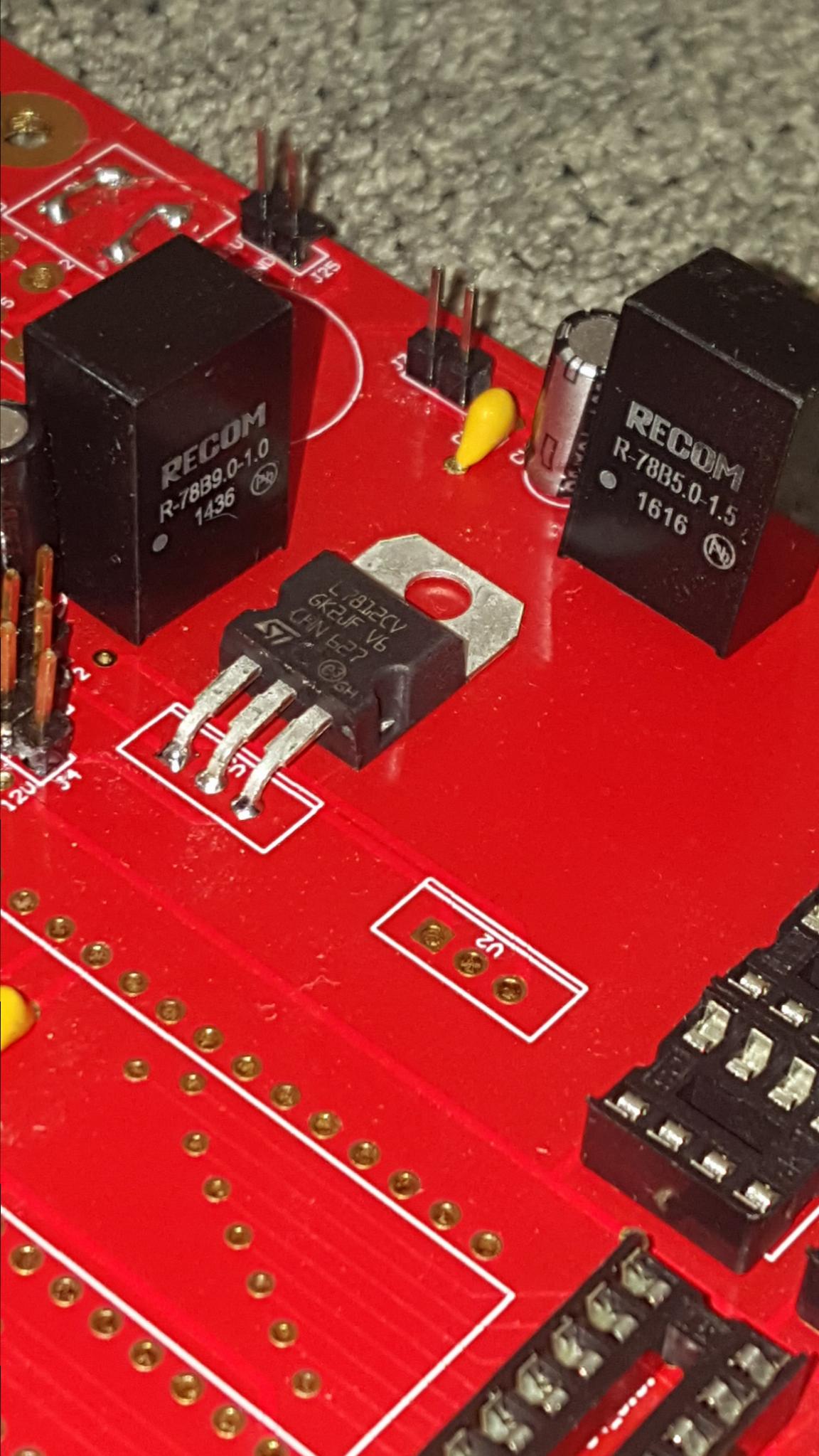

I think I installed my 9v sVreg backwards.  Please tell me I don’t have to desolder this thing lol.  (I know I do)
