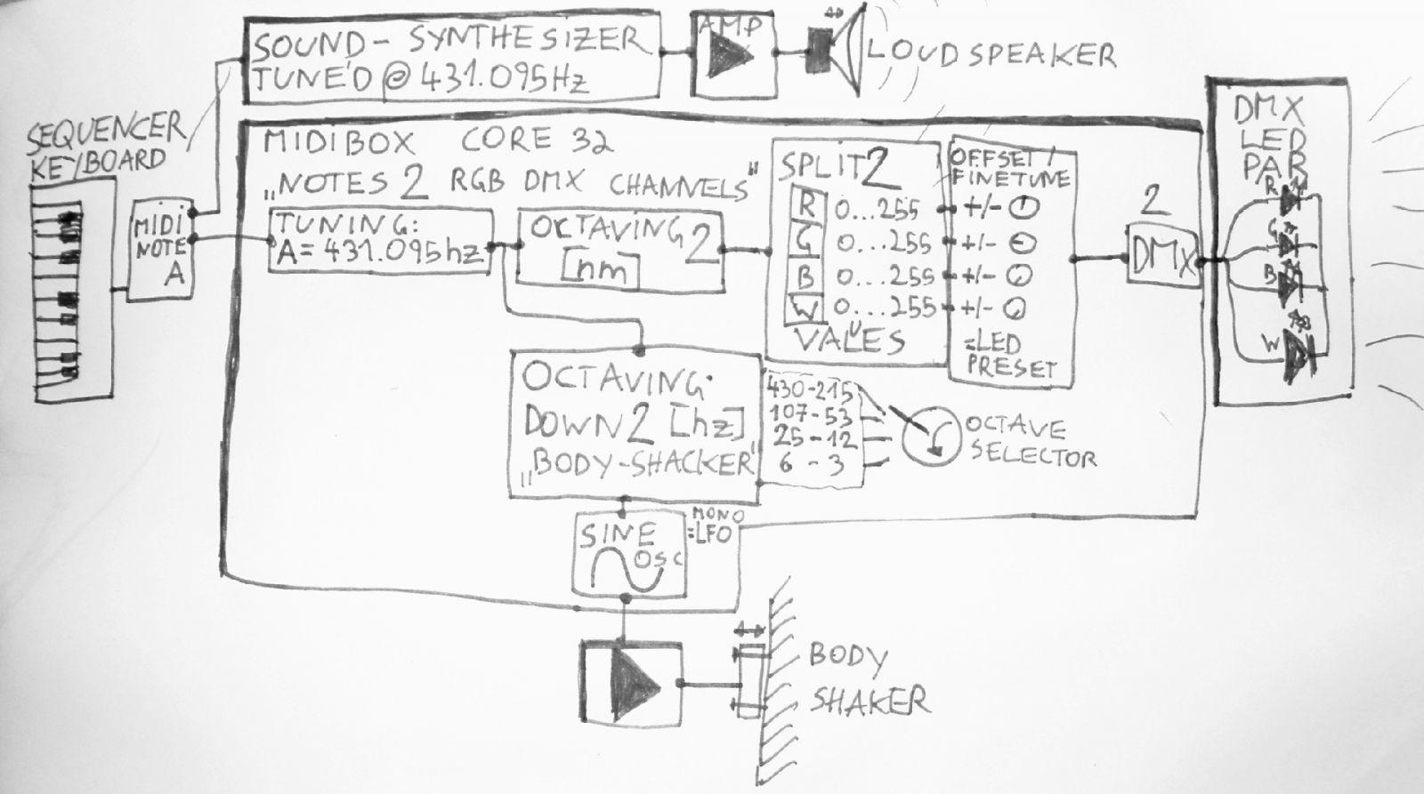

A Midi Note has a frequency, this frequency octaved to a visible spectrum is colour…
the goal is to connect a RGBW-LED-DMX-Light via a DMX cable to the midibox Platform (Core32 LPC17).
Software Side the octaving and the RGBW (4x 0-255) is handeld…

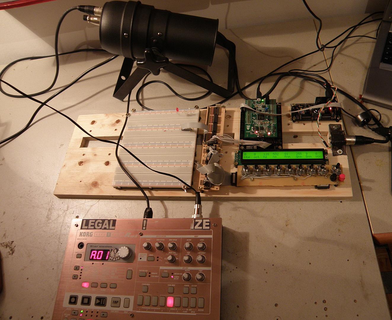

001 Setup1 RGBW DMX CORE32
the first parts of the test setup

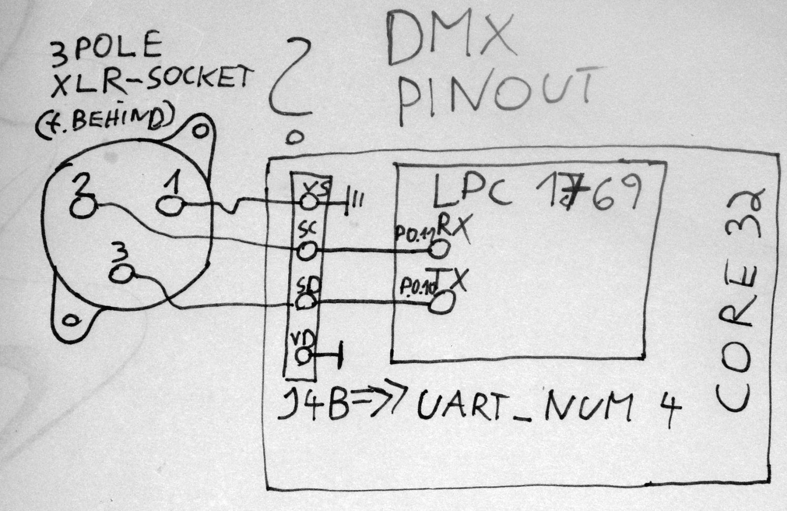

002 XLR DMX Connector
DMX Pinout
003 Basic Idea sound 2 light
004 Core XLR DMX Pinout
is this the correct pinout???

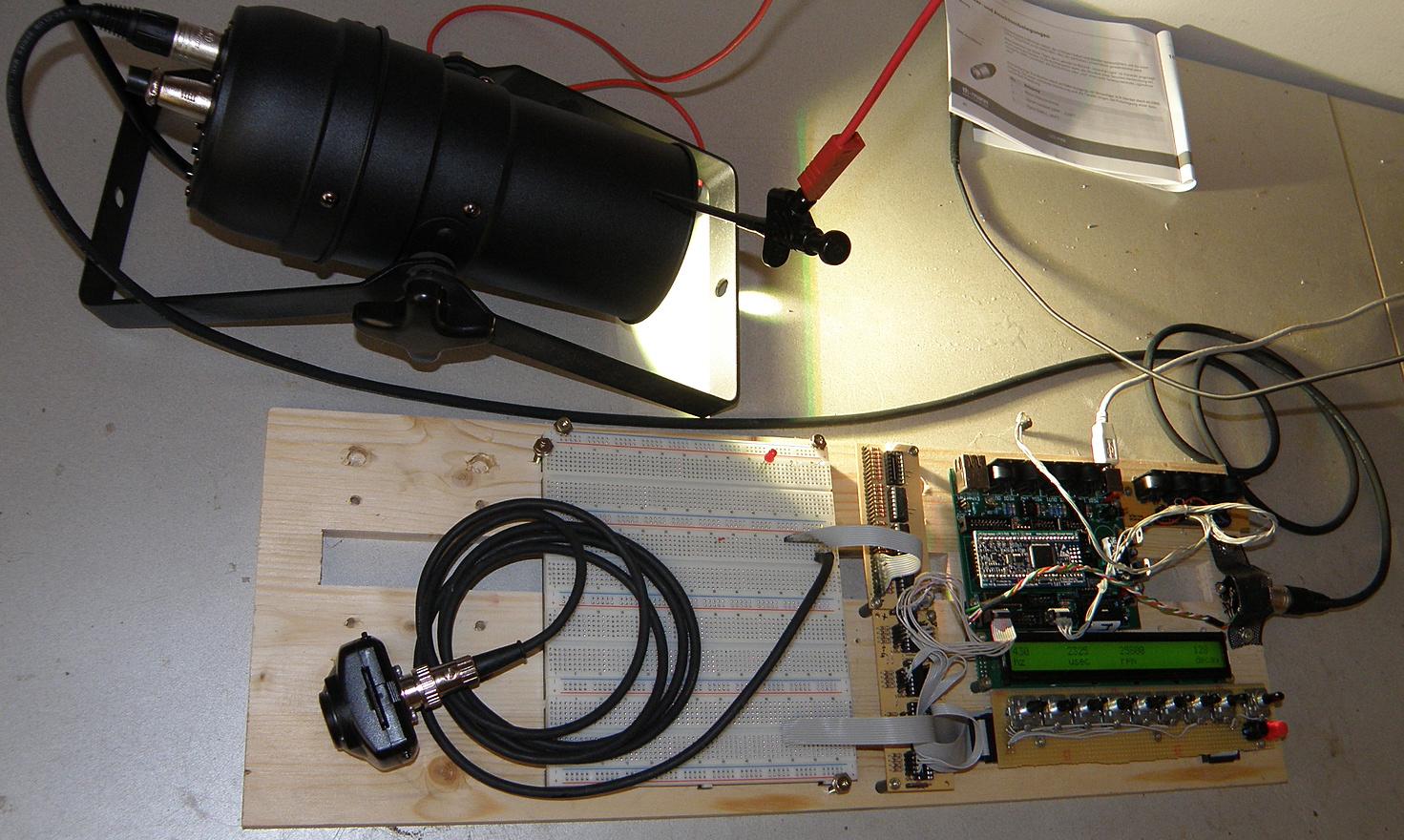

005 Changing CORE
swapping from LPC17 to STM32F4 dont bring DMX to live
