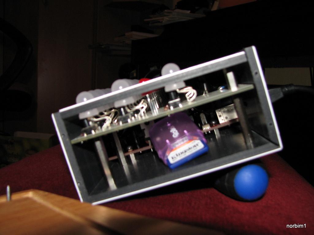

IMG 5162
I soldered the cables directly to the front panel PCB, so the overall height can be smaller. There are 12mm spacers between the FP and PCB, 30mm spacer under the PCB. The LPC panel sits on 5mm spacers.

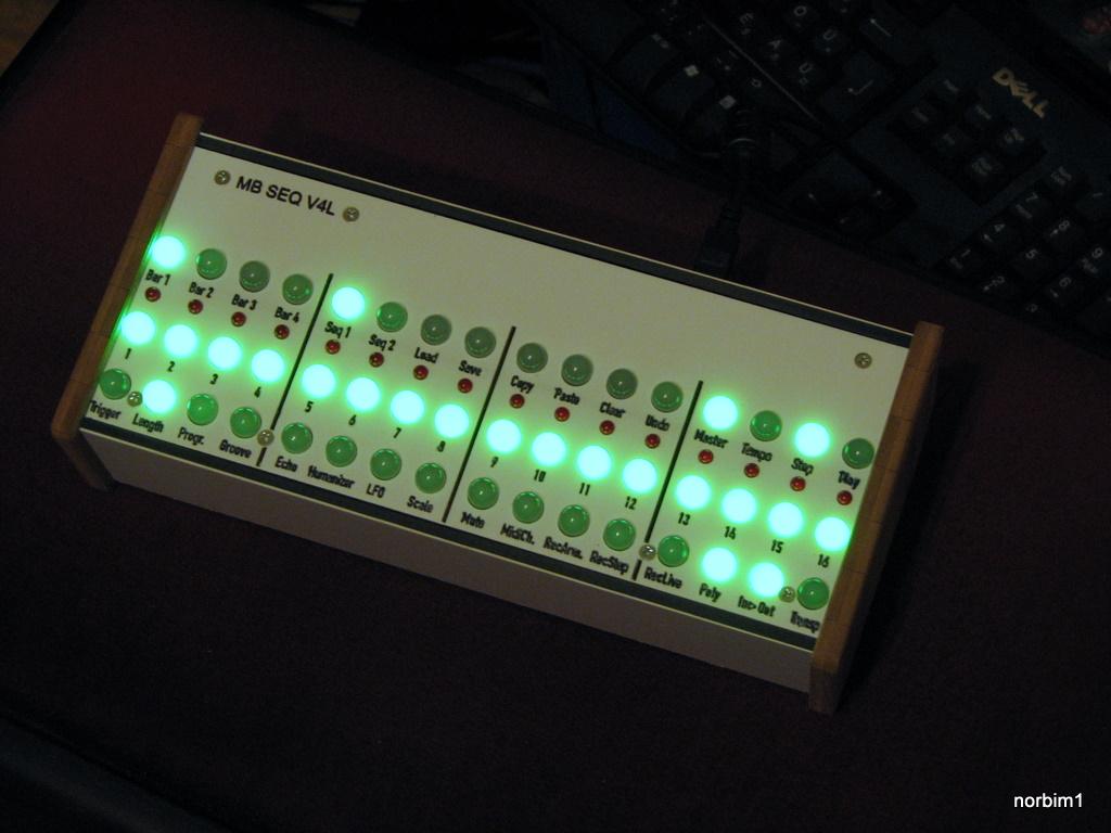

I’ve just finished my V4L case.

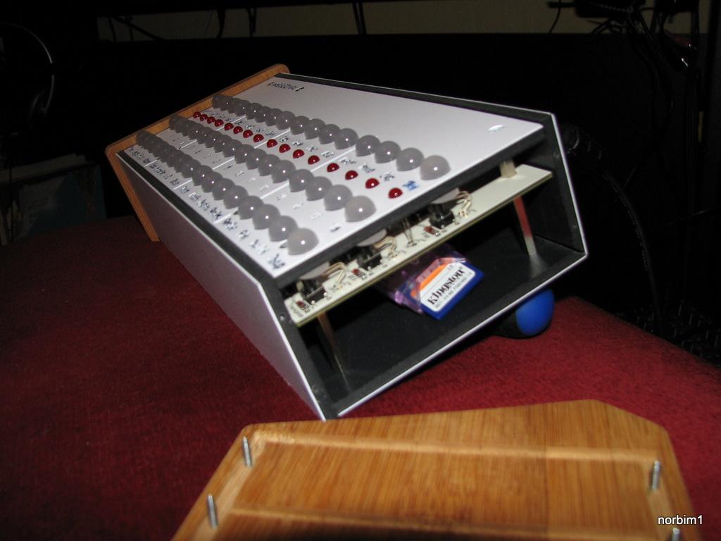

IMG 5155
IMG 5160
My front panel solution: illuminated buttons with the original PCB. 10mm green diffuse LEDs for buttons, 5mm red LEDs for the seq disp.

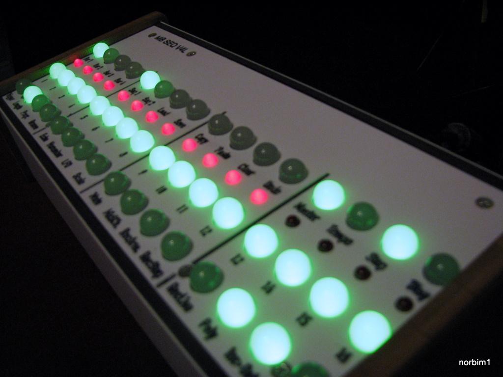

Re: IMG 5153
Yes! You read my mind with the backlit buttons, totally the direcion I am headed as well.
Re: IMG 5153
Nice, it looks like some evil mind-reading-machine from an early sci-fi flick :-)!
Well done!
Re: IMG 5153
That is awesome!!!
Re: IMG 5160
very nice work!
Re: IMG 5153
Agree Hawkeye,
it really recall " Electronic Brain " from 60s sci-fi.
I like it :thumbsup:
P.S. are 10mm LEDS ?
Re: IMG 5153
Thanks for your comments. Yes these are 10mm diffuse LEDs.There is a closer look here:

Re: IMG 5153
holy crap, I didnt even know they made them that big
Re: IMG 5153
the biggest

Re: IMG 5153
Damn best leds ive ever seen looks mind boggling for some reason. Nicely done!
